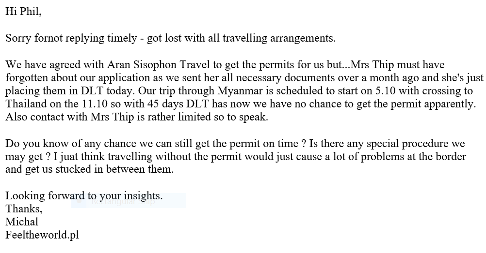

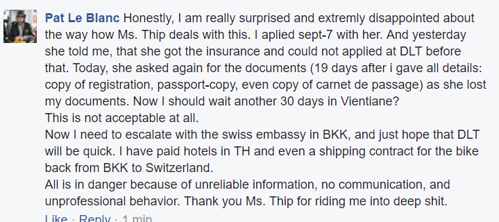

It is possible to get sooner, these are just guidelines to stop people getting cute and causing panics, calling embassies etc....
Give yourself plenty of time. Just cost this guy USD 1,000's
True. May I also make a suggestion - getting angry like this guy solves nothing, this is Asia after all. It is understandable some people are frustrated, especially since this process is still new, but as Myanmar, China and certain other countries also require a long time to make arrangements, overlanders should expect the unexpected. As you say lots of advance planning is necessary - preferably before leaving your home country.
Another one in a mess. If they all go crying to their Embassies, when DLT isnt at fault, maybe they ban foreign motorcycles from all the hassle it causes?
