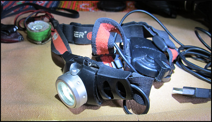

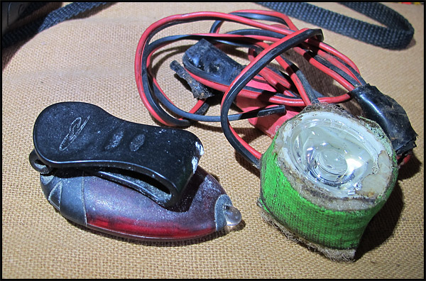

2.headlight & spare batteries

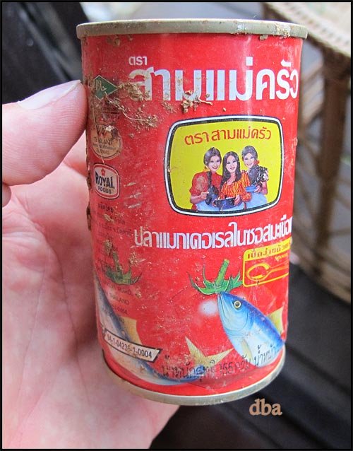

3.emergency food (dried bananas, cashew nuts, biscuits & tinned fish that can be eaten with sticky rice in any villiage)

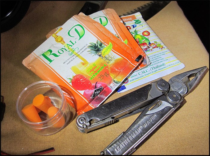

6. leatherman

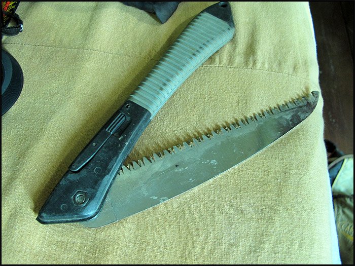

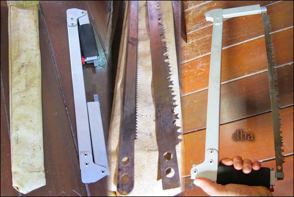

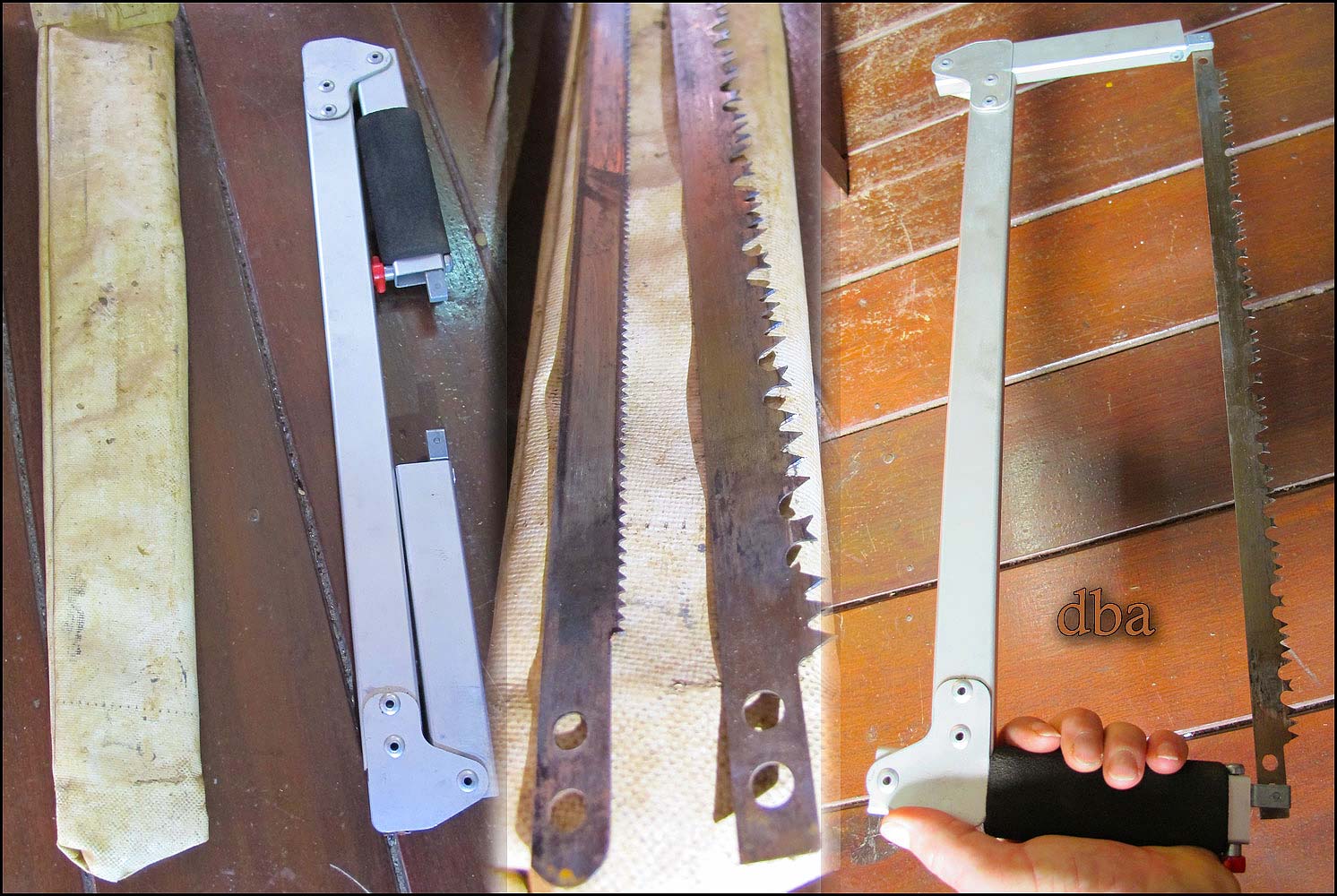

9. foldable hacksaw ( make fire, cut bamboo, cut trees on the trail, make support for bike), the piece of wire with a handle at both ends is a toy

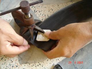

A query on the inner tubes. Am I correct in saying that a front inner will be usable in the rear if need be, negating the need to carry both or would it be prudent to carry both?

Front tube in the rear is a great short term fix but because it's too big you're asking for pinches and then problems.
I always have shit loads of talc with me in case I have to use the front inner tube in the rear, really helps stop the heat build up and the talcs lubrication "may" push out any pinches.
Re: Essential minimalists gear check list for jungle trail t
I like the metal tube idea with its outside diameter the same as the inside diameter of the cooling hoses, 15cm long would probably do it.

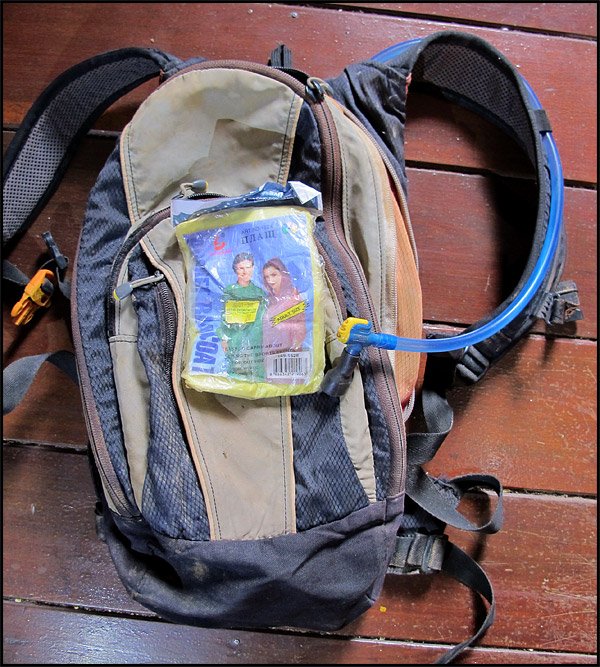

I'm using the Giantloop bag as my main bag on the bike. here's a pic and description of whats in it.
From left to right by row:
* Clothes in two zip lock bags (one pair of shorts and one pair of travel pants that can convert into shorts, couple T-shirts, 3 pair of socks, 3 pair of undies, 1 long sleeve thermal top),
* inner tubes front and rear, pair of shoes rubberbanded together, (I take more food than most because i'm a type 1 diabetic and need my food) cereal with lots of raisans and some M&M's added and powdered milk packaged in tiny zip lock bags ready to just add some water and eat in the bowl with spoon.

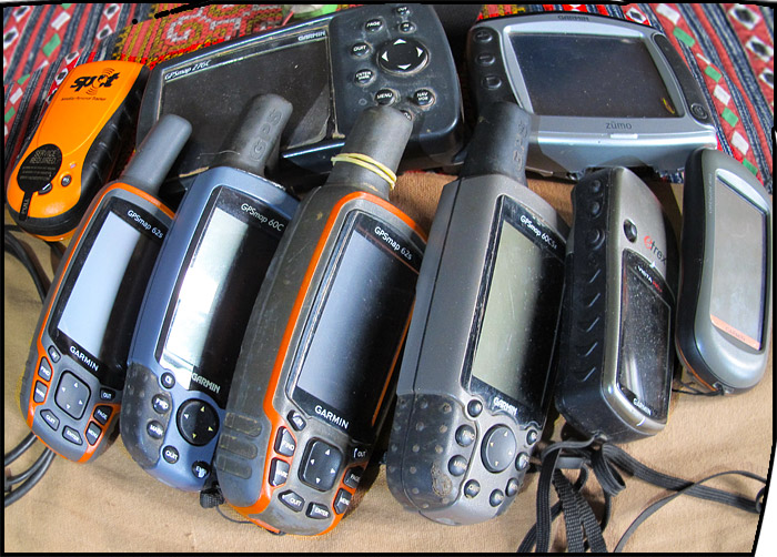

* Garmin carry case with my electrical cords for camera and phone charging, spare batteries for headlight, dark blue nylon bag with spares, nuts bolts, epoxy to repair holed cases, spare levers ziptyes,etc etc, hoseclamps, wire fuses,, Oishi Ice tea bottle because it is enforced with ridges that is full of oil for emergencies , ie hole your engine case and after patching with epoxy need to put some back in. Black bag with tools , zipl lock bags of dried fruit and ziplock bags of dried meat and every couple days I always stop in a village and get a few meals of sticky rice to throw in for carbohydrates. After a couple days it dries out pretty bad so every feew days spend 10 baht and gett another bag full.
* Hammock complete with mosquito net, rainfly.

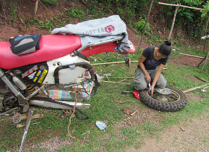

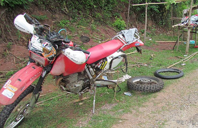

I always pack spare tubes, pump and the necessities of the "pien Yang" process, this includes the girlfiend as the pictures will show..

I just came back from a brutal five day ride along the Thai - Burmese border, and made a few observations along the way..... :-) Most important thing ?? Water. Think how much you need and double it. If you are working hard through the mud, and pushing the bikes up steep muddy hills, your water needs will increase DRAMATICALLY. Once you ever run out of water in the wild you will never forget it.
Seems like 90 % of my flats are in the rear, so I only carry a rear tube. Have never had a front flat in my life. Seems like general thinking is a rear tube will work better in the front than a front tube will work in the rear. Carry lots of mosquito repellent. With your bike running you are happily cruising through the jungle having a great time. When you stop due to bike problems, you simply become a buffet for endless stinging and biting bugs, as in giant flies taking chunks out of you. Having MREs seems to be a bit of overkill. If the next meal is uncertain, a handful of energy bars will fill the gap until the next village. Bring a few medium sized plastic bags, they have many uses. If you need to cross really deep water, use the bags to seal the exhaust pipe and the air intake, then push the bike across the river. Also if you are working on the bike, spread one on the ground to lay parts on. A tow rope or strap is critical as well. For towing, making a temporary shelter, or if you really smash up your bike it could aid is sort of keeping together by tying on stuff. Clutch levers are critical. They are cheap, carry two. I snapped off one the second day, replaced it, and spent time worrying about snapping the spare one as well....
I carry mega pain pills, 30 mg morphine sulfate. Never want the horror of breaking your leg, then spend days in blinding pain while you figure out how to get out of the middle of no where. Did not have but wished I did two part epoxy. The sight glass in my bike fell into the crankcase, and I had no real way to repair it. Tried stuffing a rag and later a wooden plug, but neither one worked. Some epoxy and some gauze from the first aid kit would have worked great.
And the most important tool of all is between your ears. When things go wrong ,think slowly and carefully about the best choice of what to do next. Hastily made decisions can come back to haunt you very quickly......

I have had torn valves on front tubes when running at low pressure before & if you carry a front it will go in the back to get you home. I carry a front and a rear as we tend to do some long trips.

The Sawvivor, I have 2 blades one for wood , and one for bamboo.
http://www.campmor.com/outdoor/gear/Product___47440
The Sawvivor need a stick to hold up your bike? to change a flat? firewood for warmth? build a ramp, to jump a creek or a downed tree?
Folding brush saw is great for bamboo.

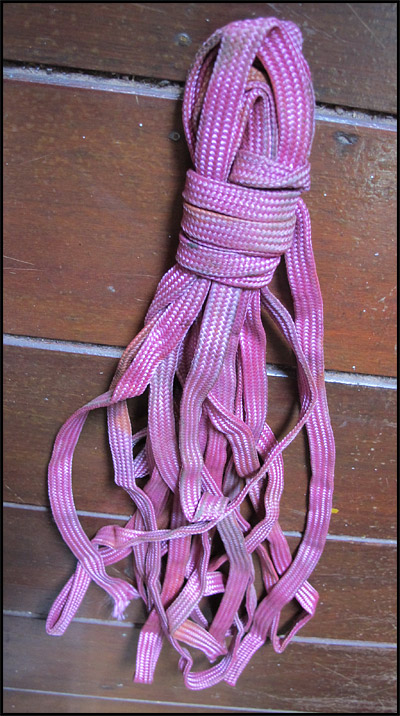

This tribesman, ran in front,(about 3 ks with no shoes!) showing me the trail, he did not ask for cash but I was so greatfull to find my way through this maze of old loggin trails! which shortened the distance to Muang Moak by 70ks!
Forget your glue and patch, take a couple of these, tire irons stradle the patch while you light them, hold them down with your boots and 2 minutes its fixed!

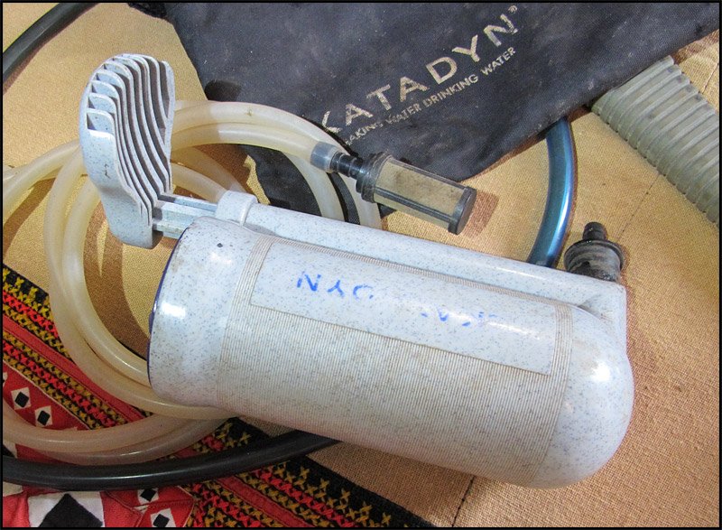

Extend your range, be safe
On extended trips, you will find yourself staying in villages, it is best to have that water filter along, this will greatly extend your range! The hammock is classified as safety equipment, camping is fun. Having your own bedding, will keep you out of those communal sleeping arrangements where somebody may be more friendly than you expect! Being self contained, there is no need to rush to a destination and make a riding mistake. I try not to take anything from the villagers in terms of food, so I always have a few of those red cans with me. Rehydration salts I like the ones with lots of glucose during those long rides! I cannot say how many times the Leatherman has saved the day! along with the Camelback and a throwaway poncho.

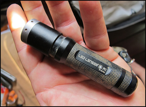

Flashlights
Led Lenser diode lights are the best in the world, at the moment, the headlamp is bright enough to ride your bike at night, this model has USB rechargeable battery setup!
Focus beam, infinite brightness adjustment, shines 150 meters!
http://www.zweibrueder.com/ENG/produkte ... php?id=h7r
The "Mighty Might" M1 is run by a CR123 lithium Ion battery.
This light will shine over 100 meters and will focus the beam, 3 levels of light. (sorry about the mud.)
http://www.zweibrueder.com/ENG/produkte ... .php?id=m1
A homemade 3 watt led I use for camping, will Velcro to the back of the rear view mirror and can swivel 360 deg running all night using bike battery, great for set up, for camping.
One final light, is the watch battery led with stays on me all the time.
Everything above was purchased at Sim Lim tower, Singapore.

GPS
I usually take 2 units along, as I am collecting geographic information.
A GPS loaded with a the LaosGPSMap. is considered safety gear and is essential for navigation. This map is designed for expedition travel, were all tracks and trails are recorded along with vital information, such as village locations, streams rivers water crossings, fuel, hospitals act.
http://www.laosgpsmap.com/

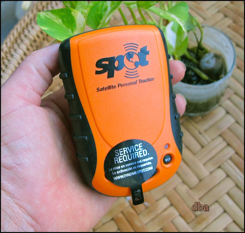

Spot locater is a fantastic way to let people at home now were you are and call for assistance.
http://international.findmespot.com/
Don't forget you cell phone, and an M-phone prepaid sim card! you will be amazed at the cell phone coverage in Laos! 3-G data connection you will be surfing the interenet in some very unexpected places!

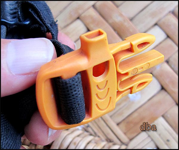

Finally, a good emergency whistle, I keep one on my camelback harness at all times.

Nice ideas there Mr. D ...im going to get a water filter as well, we all ran out of water on our last unplanned evening in the jungle.

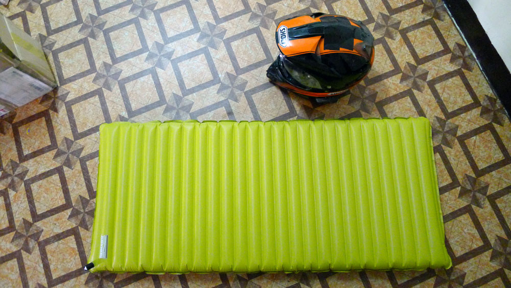

Something I always have with me on overnight trips when you know you're going to be away from towns is my Thermarest Neo Air air mattress.
Deflated its the size of a tennis ball, i'm not joking. This is the XS model, so you use your Jacket as a pillow and your feet will hang off the end, but that's a small trade off for is deflated size.
Stuck somewhere, this makes a nights rest in a straw hut or on someones floor not so much of an issue.

Don - have you activated your "Spot" yet?

Air mattress comparison
The red air mattress in the Thermarest pro plus, which most people say is the best camping air mattress in the world. The yellow one is the Thermarest Neo Air XS size.
The disadvantage of the Pro Plus over the Neo AIR XS, is that deflated and rolled up the Pro Plus is 6X the size of the Neo Air XS and weighs probably 4x as much. Obviously there's a comfort trade off, but i dont think you can beat the Neo Air XS for emergency sleeping (deflated the size of a tennis ball).
+1 for that question - envisaged getting one for riding around SEA but seeing the price (US $100 for the cheapest unit + another US $100 just for one year service), I decided I was going to use a 3G card and figure a way to let folks at home track me using the iPhone..

Don- what's the brand name of this inner tube repair stuff? ill google it
file.php
Never seen it.....How does it work
file.php
Chris, you put the tire irons on the patch to hold it in place and you somehow light this stuff to vulcanize the patch, im still in discovery mode on this too, sounds interesting.
I am sure you have seen this Shark hot patch, most people think you need that clamp so do not carry the patches, but with a couple tire irons holding it down it works just fine, light it with a match or lighter and you have a hot patch vulcanized fix.
First for me...Brilliant
What happens if your lighter breaks?
