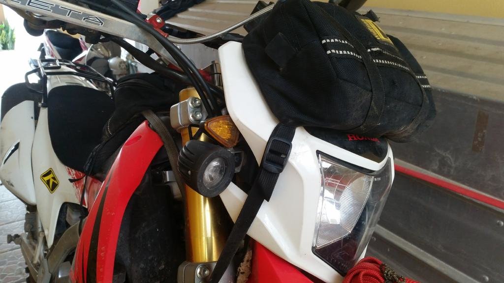

Was thinking about adding a pair of LED fog lights but couldn't find the right kind of clamps for fitting. Most auxiliary lights that I've seen seem to fit onto crash bars.

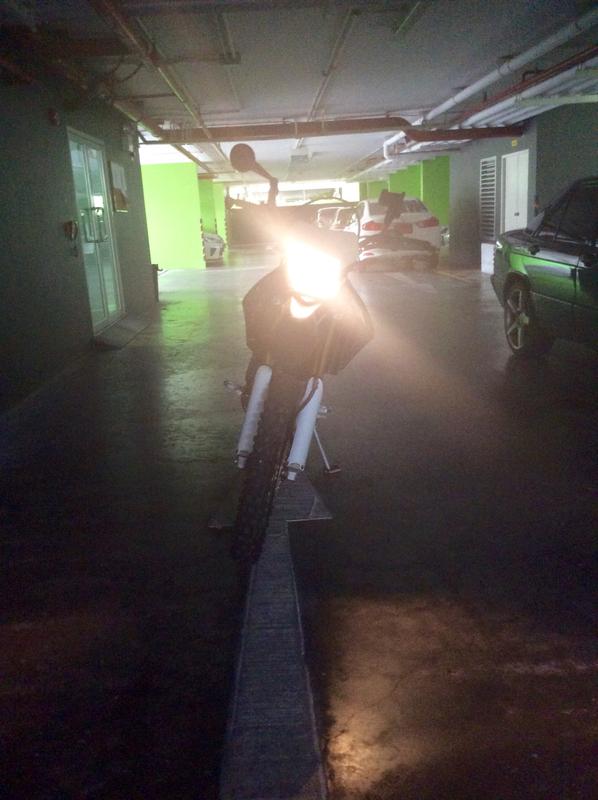

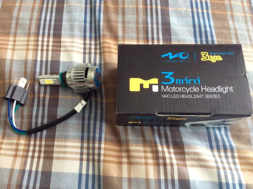

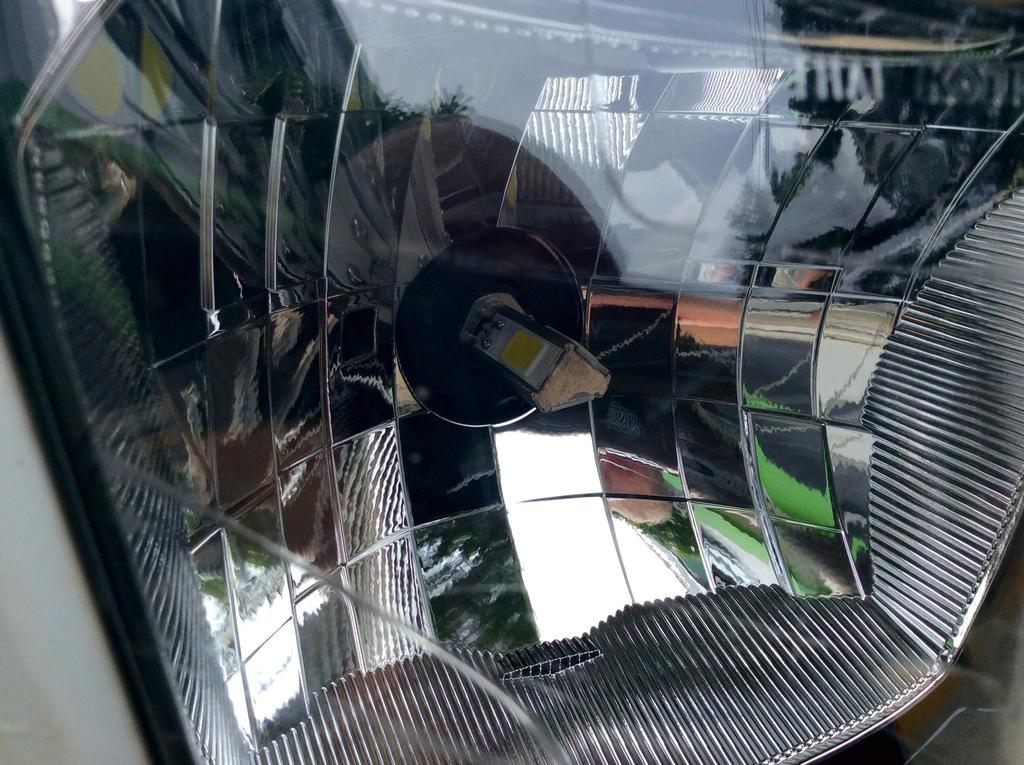

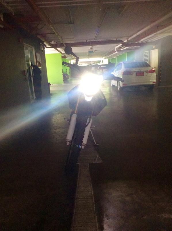

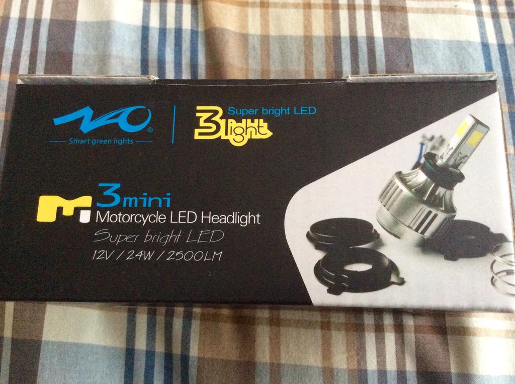

Ended up buying an LED headlight from this guy in Bangkok http://www.ledsuperbike.com

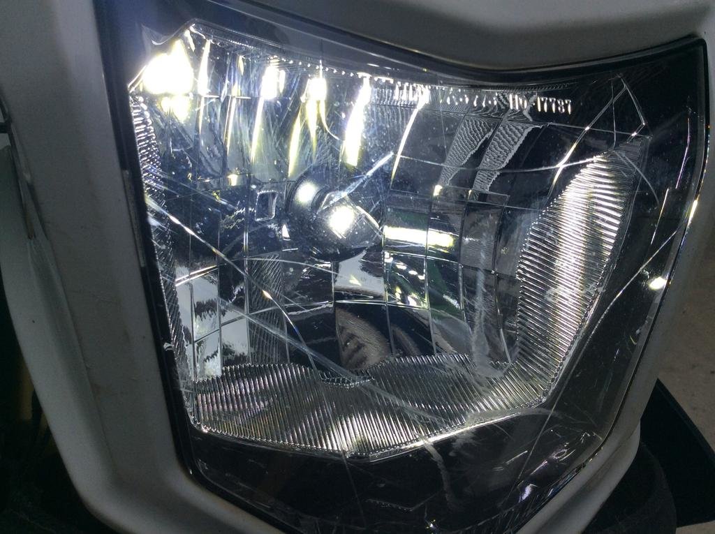

Fitted the light this morning. Looks visually brighter. He sells white and yellow, I went for the white. Price is 990฿ including EMS.
OEM bulb
LED bulb
That's where I wanted to fit the lamps Bob. Did the lamp and fitting come together? Sourced locally? Thanks.
Cheers Bob, I have the same as yours, back and front. What size did you go for? (Watts, Volts, Lumens etc.)
10 watts gives you a nice flood of light

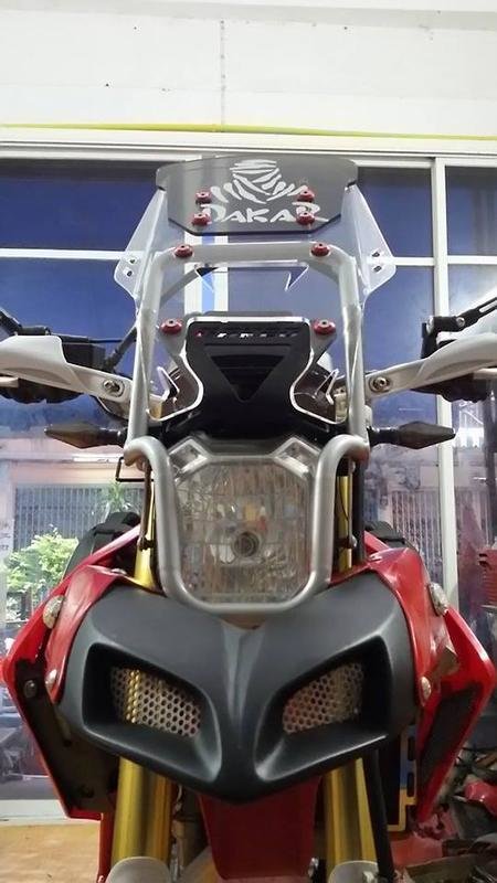

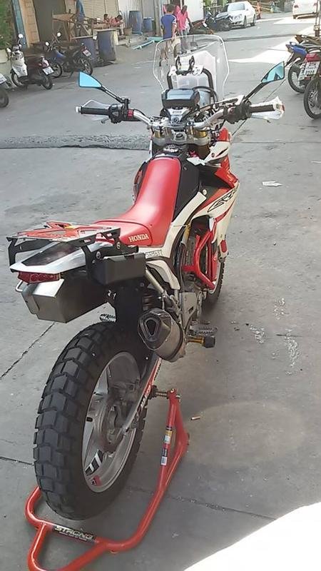

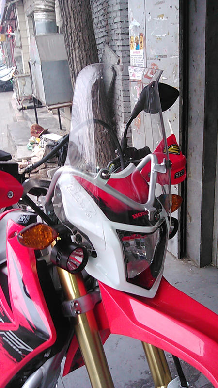

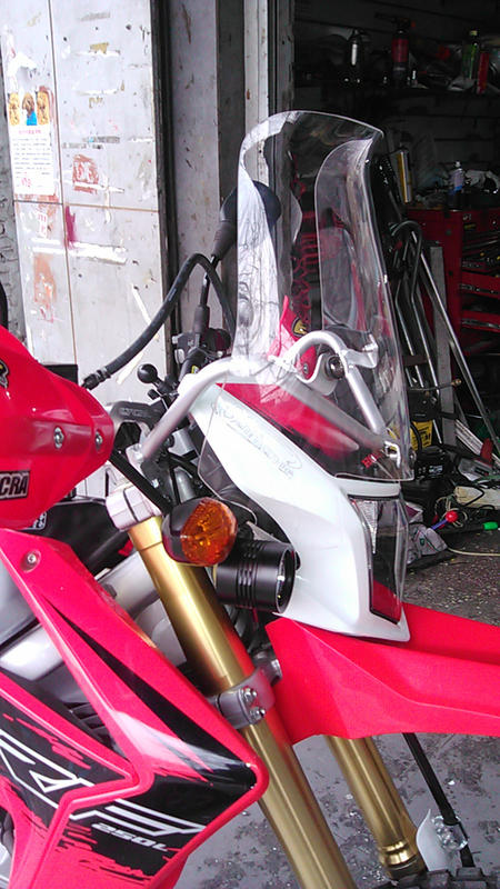

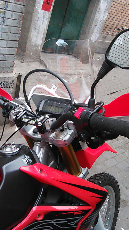

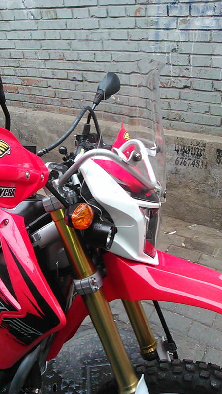

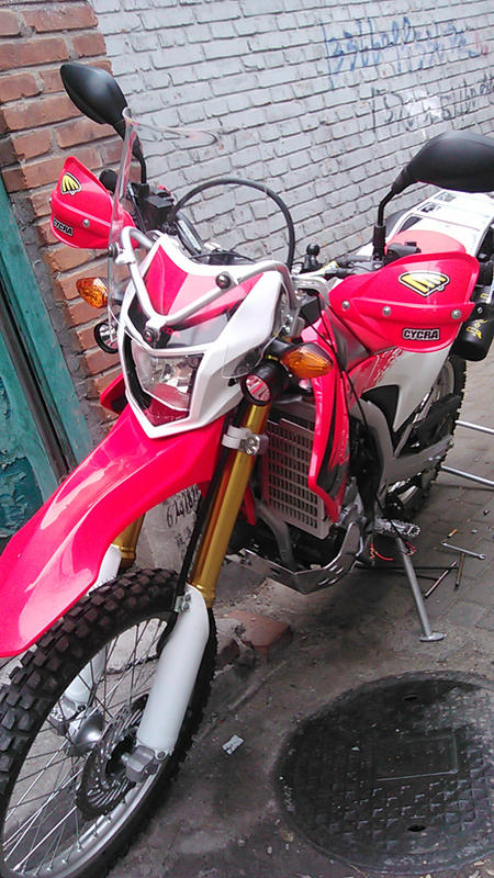

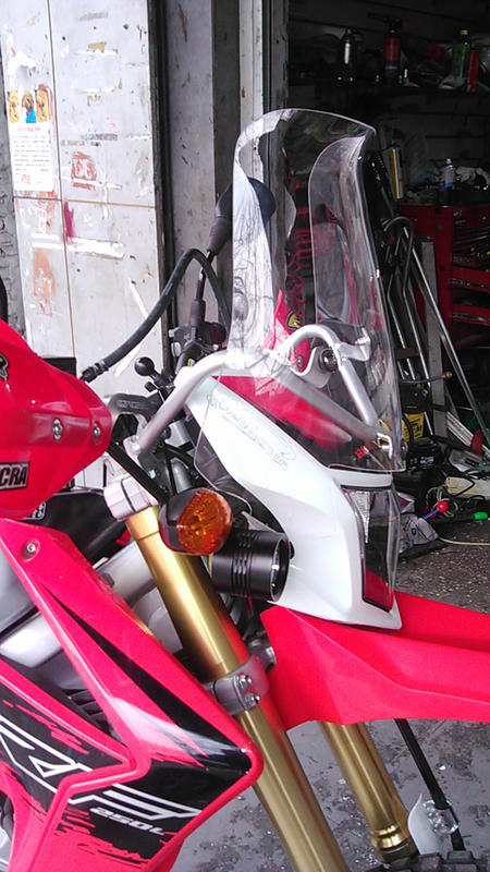

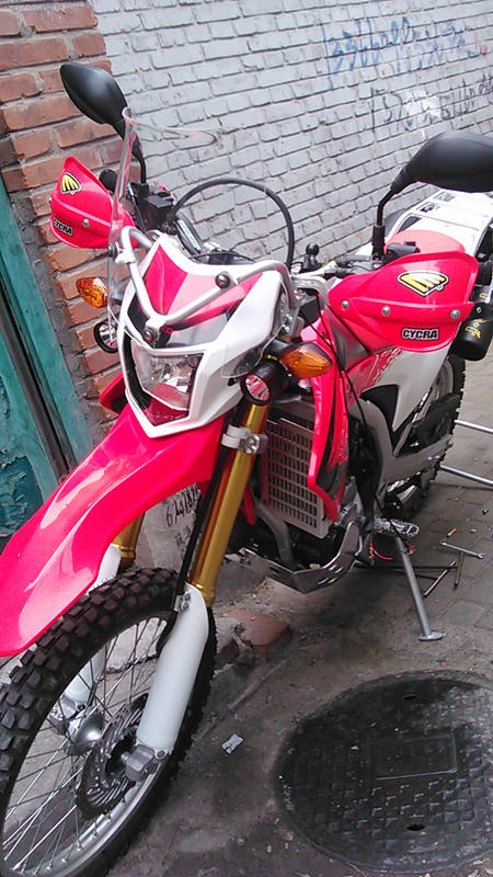

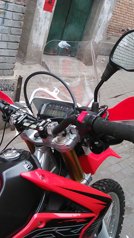

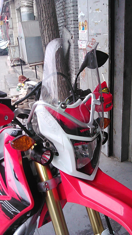

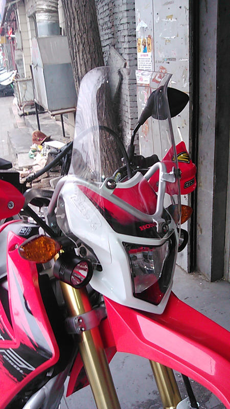

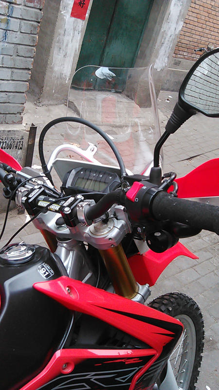

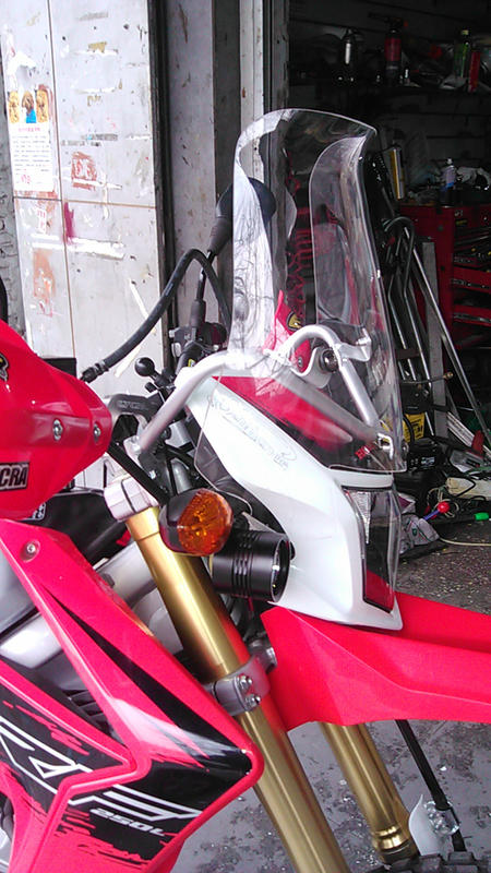

Add Wind screen .
Found at a local Big Bike Shop .
K2 factory for the CB500X, 1900 THB
Little cutting and bending and it fits the CRF
Selfmade brakets.

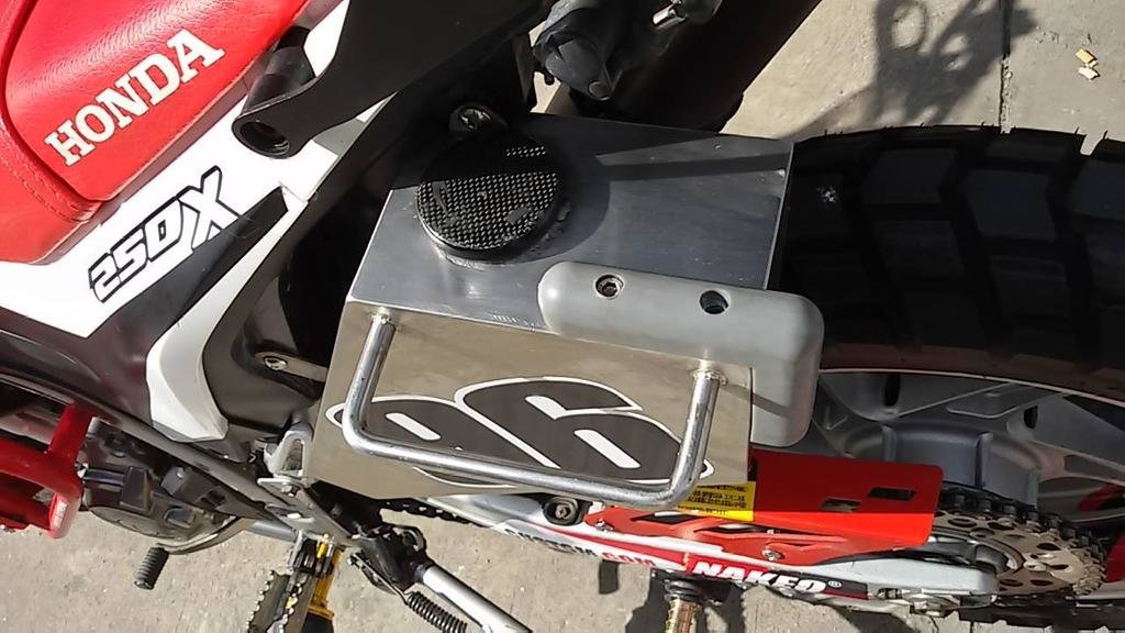

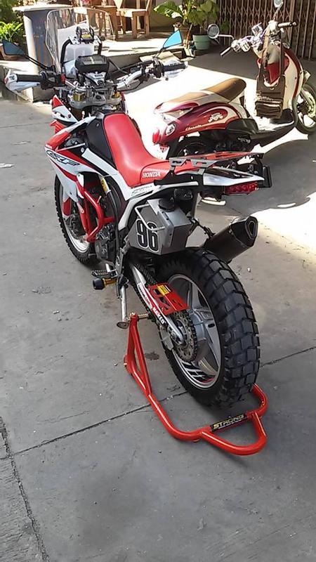

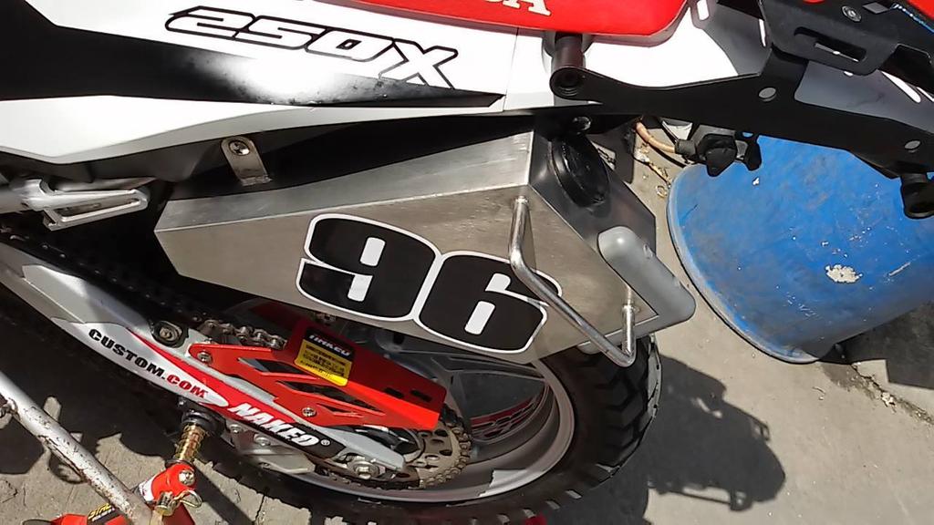

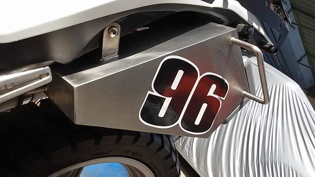

I like the idea of an additional fuel tank replacing the tool compartment but not too keen on the 17" alloy wheels and low placed exhaust muffler.
12208274_449054578613619_6812566792487687552_n.jpg11224764_449054548613622_334643492817117188_n.jpg12193593_449054485280295_4775825303608289610_n.jpg12192003_449054521946958_1744078530054743030_n.jpg

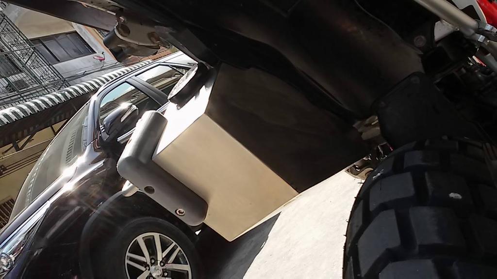

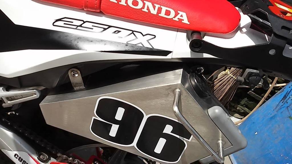

The fuel tank is 1,250 baht, trying to get more info on fixings etc....
Some pictures of the tank, this is a prototype and is simply a stand alone tank and is removable via the two existing mounting points of the toolbox, they have plans to hook it up to the stock fuel system. It is available without the handle if required.

I was wondering how tough this metal tank was in a spill too. Also that handle looks like it could snag easily. The rotopax look safer but they add additional weight where you don't want it unless they are side mounted.

The handle is to hold the tank as you dismount the tank from the fixing points !! As you need to take the tank of to drain the fuel out !!!
Also look at the fuel cap !!! the fuel will spill out before the tank is full that's my 2 cents on this design would be better to have a pump to pump the fuel into the main tank and do we know how many liters the tank holds !
