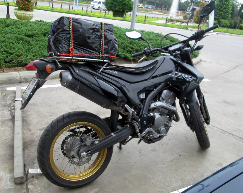

Don't think the CRF-M would work on dirt, i have used it on some easy dirt stuff and IMHO the rear spring is way too stiff for off road work, so add a L spring to the conversation list and you're well on the way to buying a spare L for dirt work :?

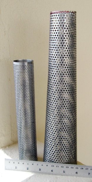

On my search for a core I was told to check a shop that sells parts for two-strokes and came across a 1,5" core, 9" long, for old Suzuki 125 and such. The thing cost 100B and was a bit flimsy, I could squeeze it into an oval by hand, so I kept on looking.
Had a metal shop make up a 12" long core with a 2" and a 3" end so the core is parallel with the outside walls.
Quite a difference in size and quality. The holes in the right core are bigger but this is the same material they use in the chromed aftermarket mufflers they hang under cars.
Now there's 1" space around the core at the end pipe and 1,5" at the widest circumference for the packing.
The widest part of the stock muffler is about 6"; if the core is 1,5" there should be lots of space for the packing!

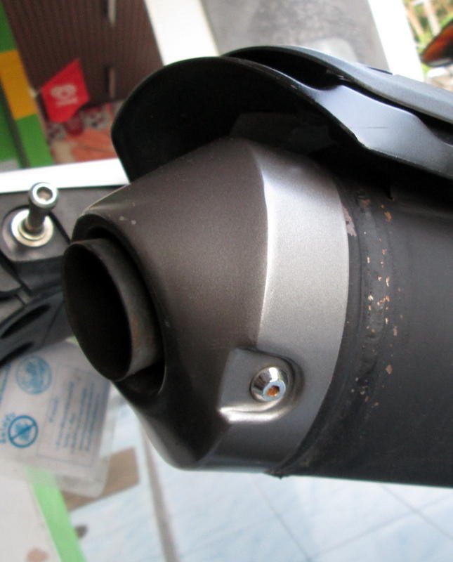

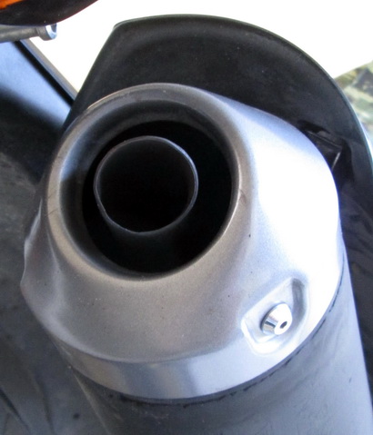

I was told by the guys who rented out the CRF250L in Phuket that the end pipe is 2". This is what it looks like:
Mine is a 1,25":
Since I got a bigger core I think I'll stick with the 1,25" end pipe and see how it works out.

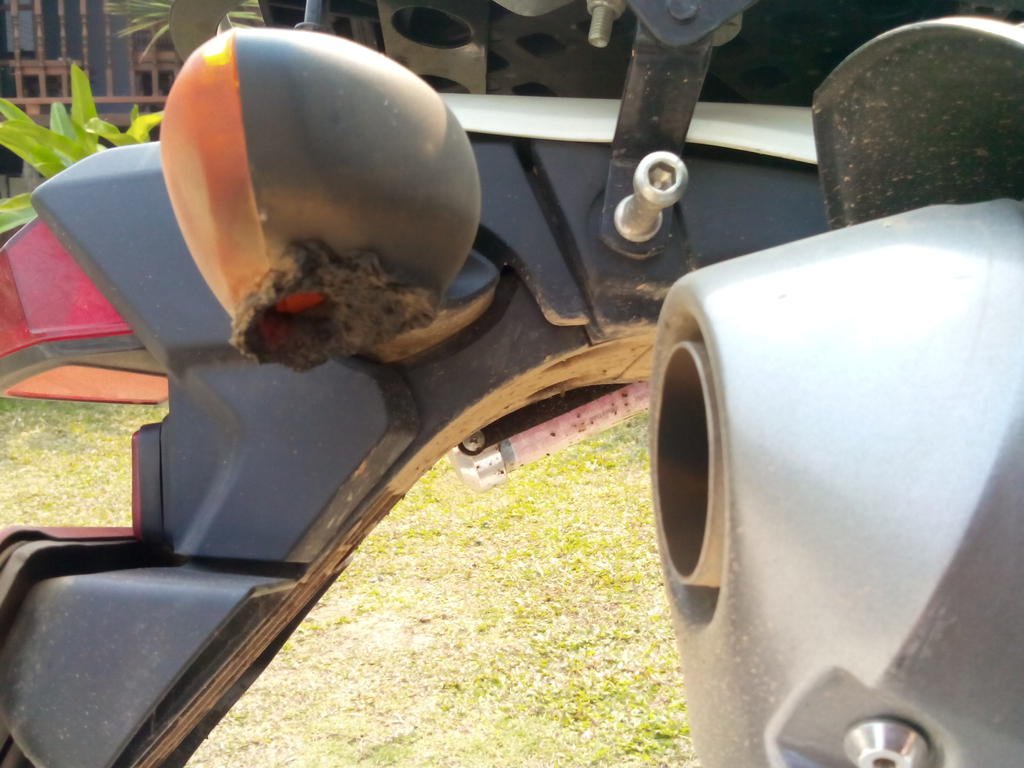

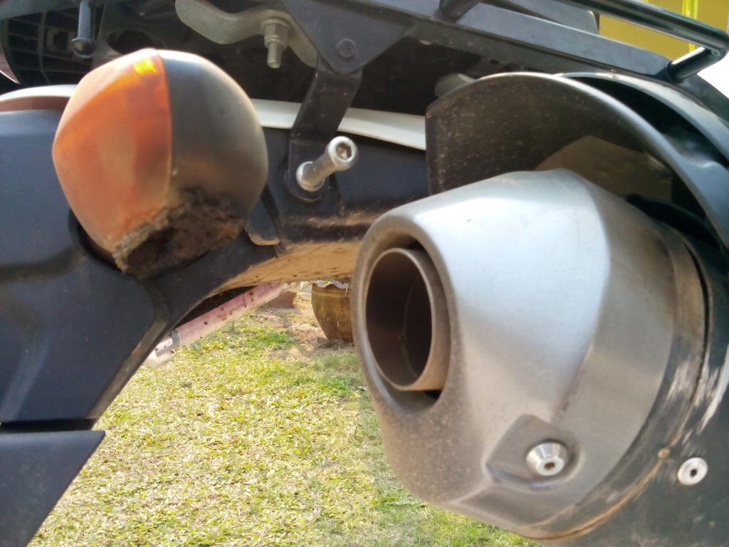

Toasty indicators
Interesting, mine has had less effect on the indicator. Might be because it's a larger diameter the gas velocity is lower and cooler?
I found an old tin cup by the road and intend to make a small heat shield but the indicator still works after @7k.

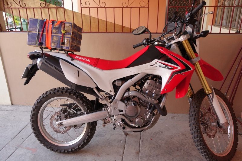

Loaded up with all I need :).
Subframe should hopefully be up to it....
I hate to tell you that it isn't.

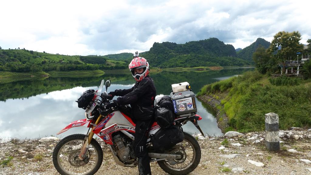

Here is Steph Jeavon's almost stock CRF (larger tank and 13t sprocket) at Mae Suai dam on her RTW trip, no sub frame issues so far.

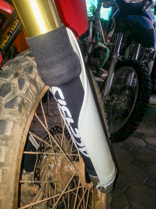

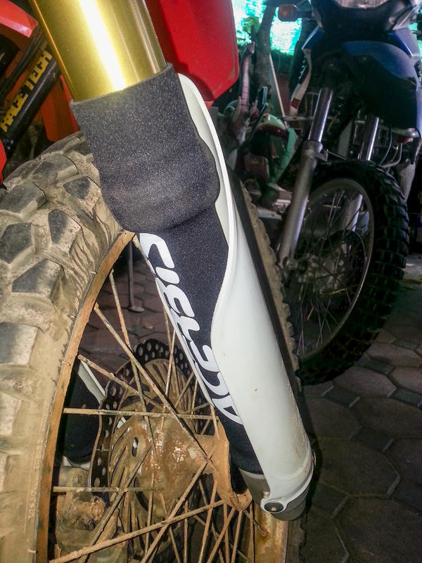

The front for dust seals on the Honda CRF 250 L do not have compression springs in the dust seals, they are only kept under compression around the forks by the elasticity of its rubber material, not ideal. Subsequently, the bike is prone to fork seal failure.
Lan at C & P, Chiang Mai installs neoprene dust guards on his bikes, he says they help tremendously, he's added some to mine too.
Cable tie on the top of each keeps them in place

Did u get these in cm please?

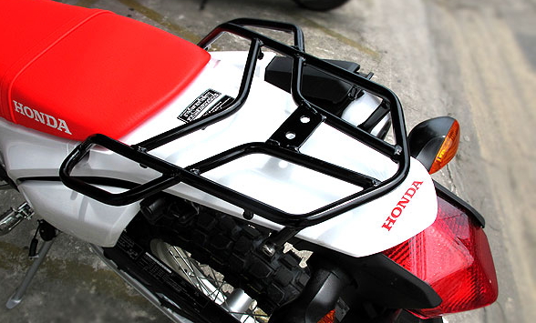

My rear rack, which I bought from a Thai seller on Ebay based in CM has useful grab handles.

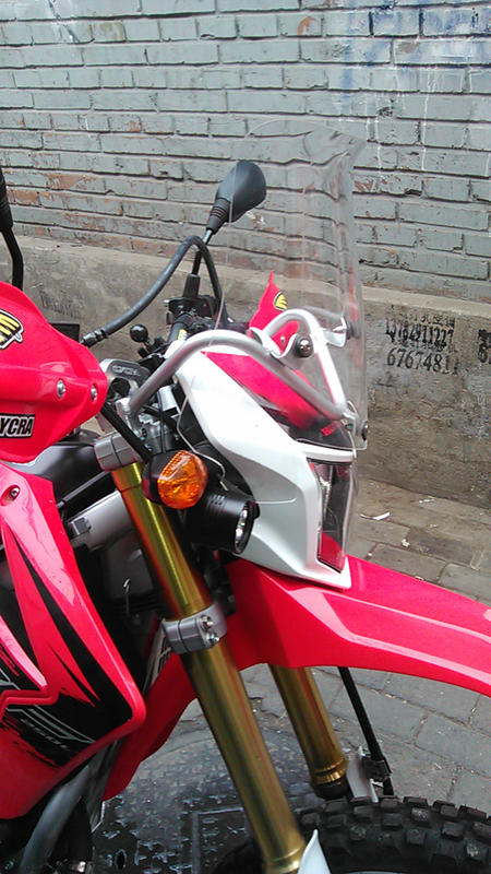

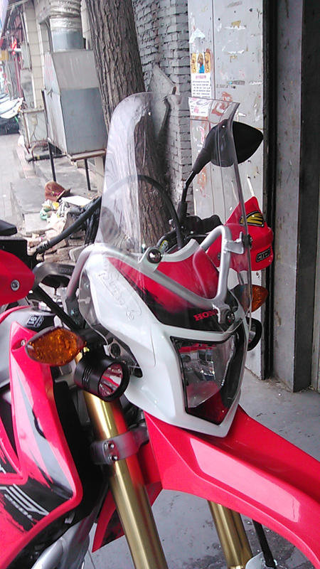

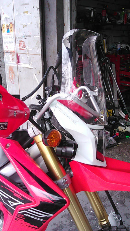

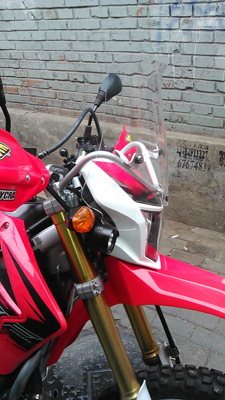

So today fixed a Givi screen ( USD40 including fitting ) .
Happy now, 110 -120 very relaxed.

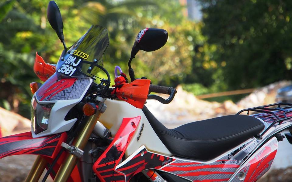

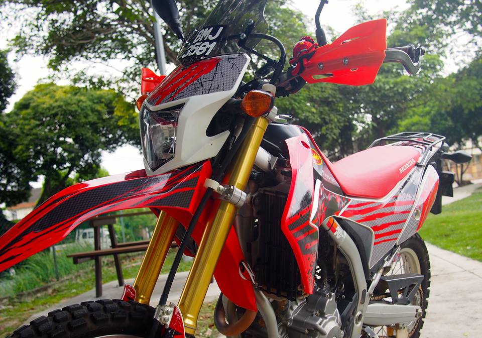

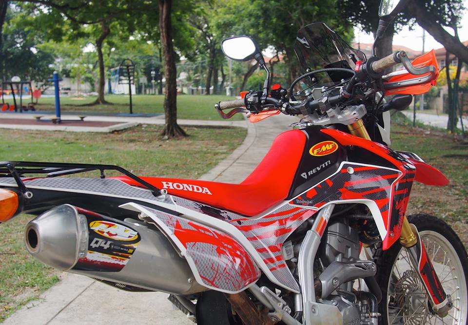

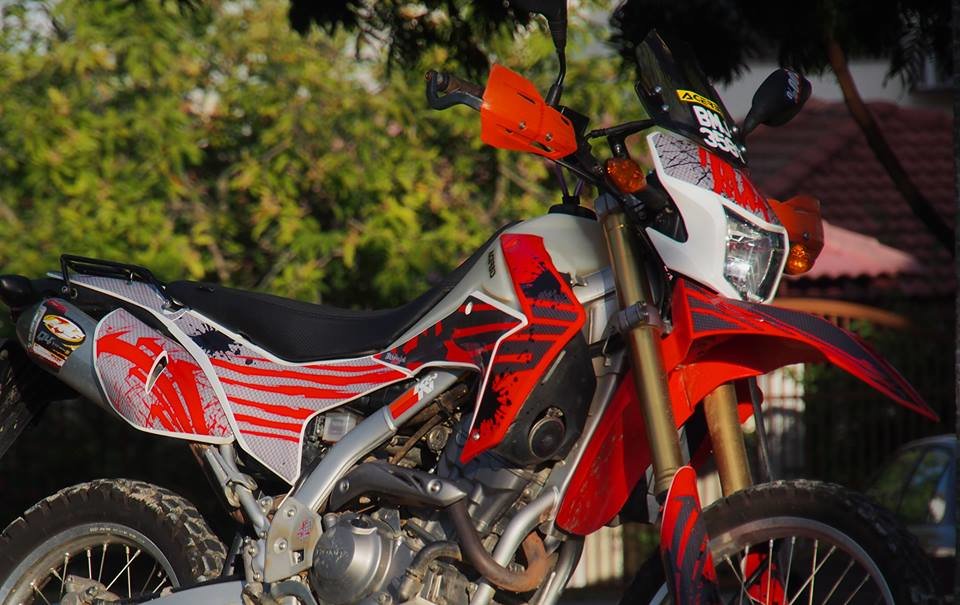

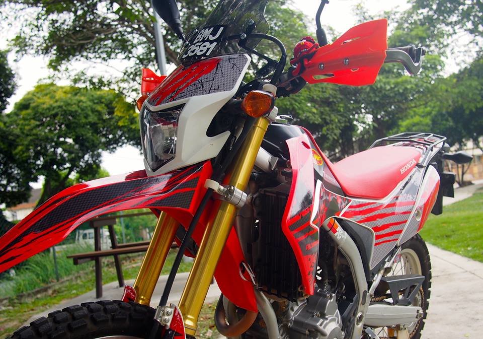

New Clothes for my CRF before the Acerbis and the Seat Concept are fitted.
11218888_10153429932106585_3221350943301352380_n.jpg11693928_10153429948211585_8614024794505049577_n.jpg

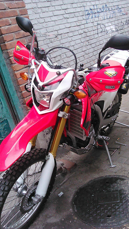

Hi nukhuzlan, where are you located? Looks like somewhere in the south?
Could you tell me where you got the screen? If it's only $40 US I'd be very interested.
After 24,000km without a screen I'm ready to try one out!

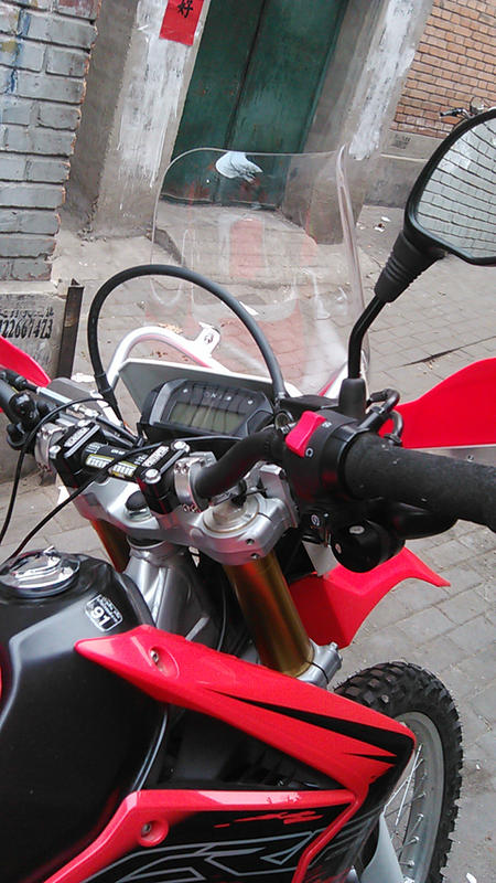

Could you post a pic while sitting on the bike? I wonder if the hardware obstructs the view of the speedo cluster. - Thnaks! :)
Hi Thump
Will have some of these over in Thailand by Mid September in clear and black much taller screen and should be about the same cost $40
These screen uses a different type of fixing point and will not obstruct your view of the dash
Hi Thump,
I'm in Kuala Lumpur. Screen is off the shelf from the local Givi shop. Mounting hardware does not obstruct the display.
I've just installed an Acerbis tank ( now 350+km no sweat ) a Seat Concept seat ( GSA comfort ). Now looking forward to do the HCM Trail in Laos in November.11101388_10153434412461585_5696637237224396205_n.jpg11403432_10153434410861585_1390254073895832271_n.jpg

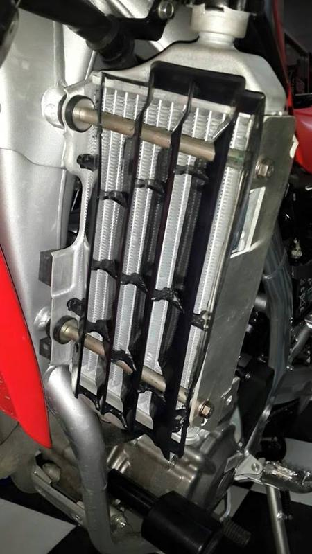

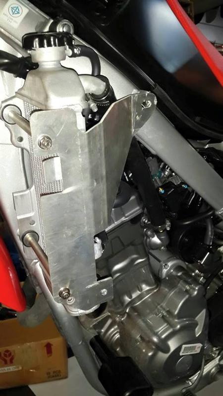

The CRF is very vulnerable to damage to the radiator and in turn the cooling fan if you lay the bike down on the left, the Burning Shop in Chiang Mai has come up with a pretty easy solution to strengthen this area with a brace and bracket assembly.
Cost 1,700 baht.
http://www.facebook.com/ball.burning
11057264_830738797042392_8361878806357433291_n.jpg 11899999_830738763709062_4910257743465585219_n.jpg
The rad guard is a good idea but that is quite expensive for something so basic in Thailand. The fab shop in Trat Wong Soi 3 that gutted my exhaust for 1000B could probably do something nicer and cheaper.
