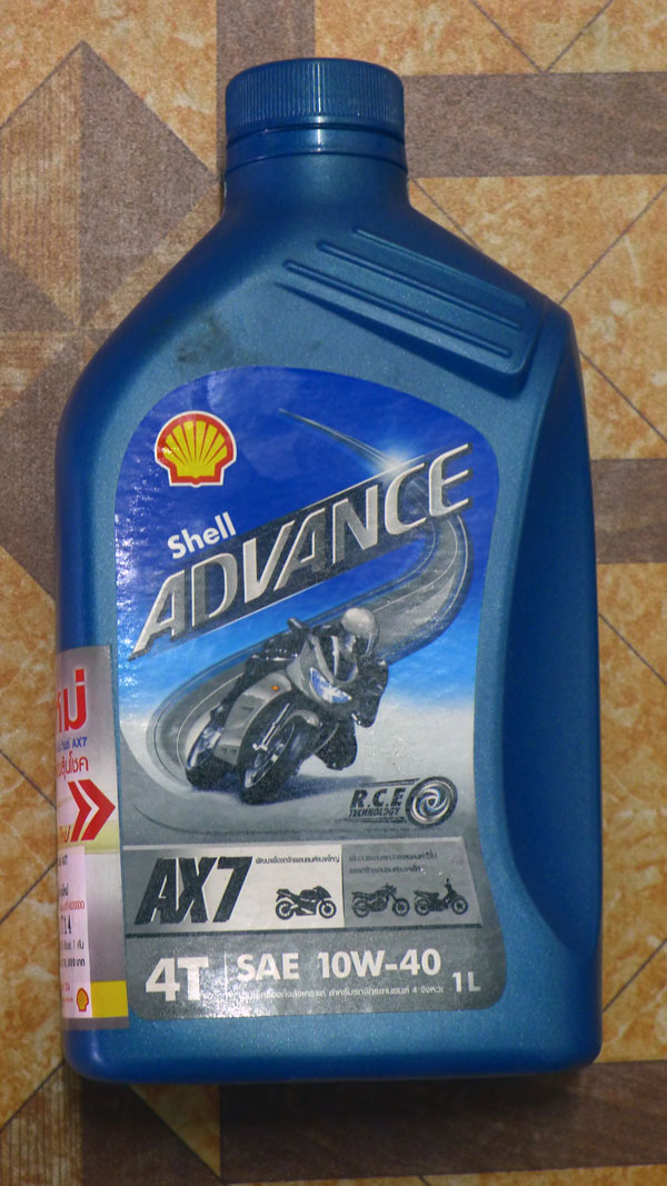

This is what ive been using in the Suzuki DRZ 400.
I think this is what Mark has been using in the tour bikes for a few years.
Shell Advance AX7 4T 10w 40
It's a semi synthetic engine oil, cost is about 140 bht a liter.
They sell a fully synthetic version for 360 bht a liter.
Im told the Thai word for synthetic (as in oil) is "sakor".

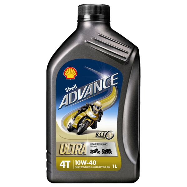

Got Shell Advance Ultra for 250b (x10) a litre at my local garage... Spec is OK - apart from top viscosity - but don't think you can get the 15w/50 version in Thailand. A local bike shop has performance 10w/60 also (forget the name) but at 720b... For the price difference, reckon I'll try with this. (KTM 250 spec says should use 10w/50 or 10w/60.) Will see if I can tell the difference compared to the Putoline 10w/60 I bought yesterday (doubt it!), or I might just add 200ml of the Putoline to finish the oil change (capacity=1.2L).
Shell Advance Ultra - Shell Global
I like this as a good visual aid to show the difference viscosity makes:
Seems to contain, at least in part, highly refined mineral oil
http://www.oilsandstuff.com/sites/default/files/Advance 4T Ultra 10w-40.pdf
refer pg 1, note 3.
Preparation Description
: Synthetic base oil and additives. Highly refined mineral oil.
