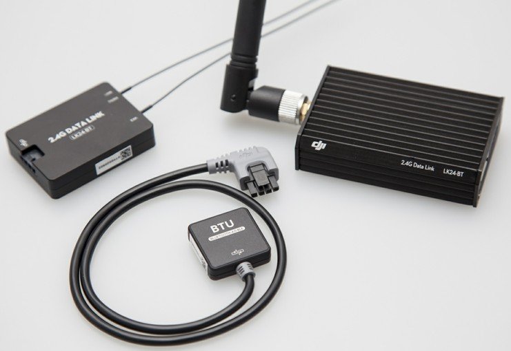

The Bluetooth Data Link and Ground Station for the PC is also amazing. Can be used on an iPad too but the PC version has a lot more bells and whistles.

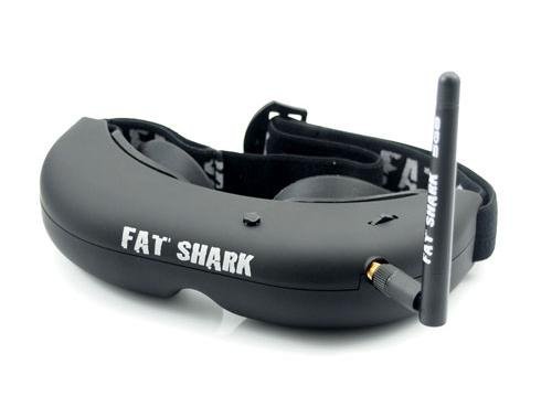

Fatshark Attitude FPV goggles should be here soon. Ive got the IOSD mini fitted but need the goggles or monitor.

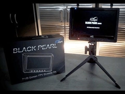

This monitor seems to get best reviews and has a built in battery.

If you buy Fatshark goggles they come with the Tx and its own little camera, however you dont use that and just hook it up to the go pro.
Doing a bit of research now and there a some comments that a GoPro isnt ideal for this application as it has a short focus length, so things will not be clear when shooting from the Phantom, is there any merit to this?

Phil, the phantom can only really carry the gopro and I've never heard anyone mention the short focal length and have seen some very amazing videos, if your looking to go bigger then be prepared to spend a lot more, I.e the z15 zenmuse gimbal that can carry a nex or gh3 etc is around 3grand alone and then needs the wookong or A2 flight controller which is another grand ish that's before you've even got your airframe, of course similar can be done for cheaper but as with everything you get what you pay for!!
