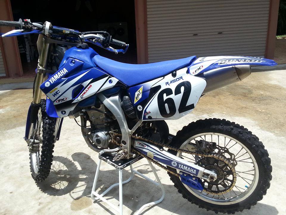

if any one else is interested in the yamaha its 100k can message me for details located krabi south thailand.just the kick start is enough of a problem really stuck in jungle 32 degrees struggling to get it going is not for me..gotta be electric start all the way really. wr.jpgwr.jpg
