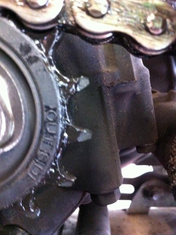

OK I just come back from the Kawasaki-doctor .... of course the doctor did not hear anything and said all was fine. I asked him to put the bike on a service-stand (I should buy me one) and open the front-spocket-cover. And looking at the front sprocket I would say it is a bit (wrongly) worn out (see attached photo). Then the doctor asked how much km I did and declared "chain too old" .... nothing wrong with the sprockets?
So I had the doctor clean the chain and lube it .... the noise de-creased dramatically but it is still there and I now know for sure I can even feel it.
So I went for a second opinion (with commercial interests but also a biker) .... conclusion : Stretched out chain.
I think chain and sprockets should be replaced at the same time .... right?
Then what to replace it with?
DID 520 Gold (Made in Japan) for 1800thb or Kawasaki stock chain (DID made in Thailand) or something else?
Front sprocket from Kawasaki and rear sprocket EK 46T (aluminium inside & steel outside) for 3800thb ?
The kawa shop is charging 3500thb for the 2 sprockets + chain (DID made in Thailand).

Ok had new front + rear sprocket + chain installed today .... and the bike rides like new. The chain was for sure at fault, although you could argue if the new sprockets were necessary. Did cost me 3528 thb + 100 thb for EMS from Udon to KK.
It is all stock Kawa, do DID 520 VP2 chain and SunStar 46 rear sprocket. I will have the old set cleaned and compare to the new set, just for learning. First look at chain seems to show that indeed quit a few O-rings are actually damaged, and weird (or not?) mostly on the inner side. But it is really amazing how much better the bike is riding .... now realising that the chain was already ****ed quit a few KM's ago.
Getting off the old-rivit link and putting the new one on was a bit more work (less easy) as I thought.
So for future savings ... I will give my chain + sprockets a bit more TLC.
Chang Noi
You should always replace the sprockets along with the chain. using old sprockets will wear your new chain prematurely. also a service stand is a worthwhile investment to clean and lube it especially in wet conditions along with checking the slack and keeping it adjusted correctly. A scott oiler would also increase the life of your chain and sprockets as well especially if you do a lot of touring miles and don't have the place, time and gear to clean, lube it and check the slack so often.
