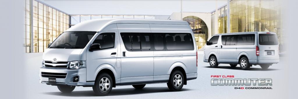

New Vans, top of the pile in Thailand, is the Toyota Commuter 2.5 liter turbo diesel retailing at 1.15 million bht.
Details:
http://www.toyota.co.th/en/product.php?model=commuter
Specifications:
http://www.toyota.co.th/en/product-detail.php?model=commuter&opt=spec

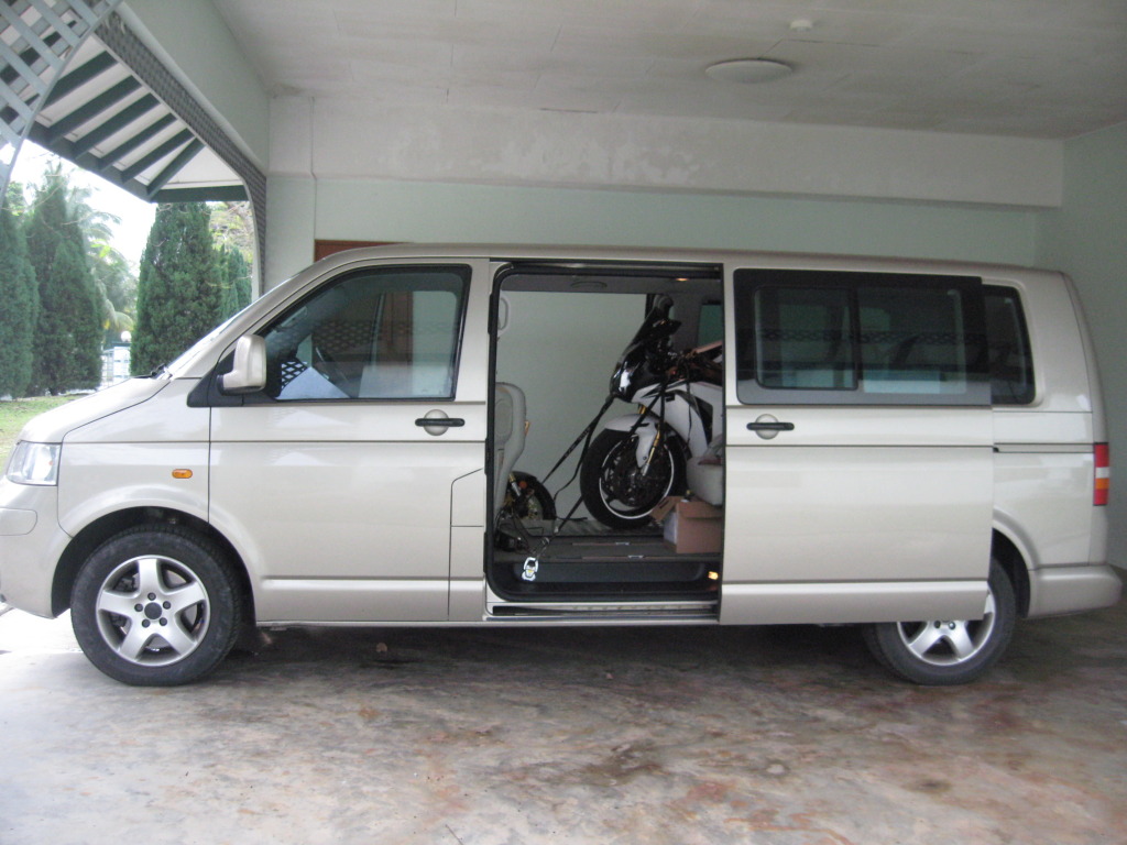

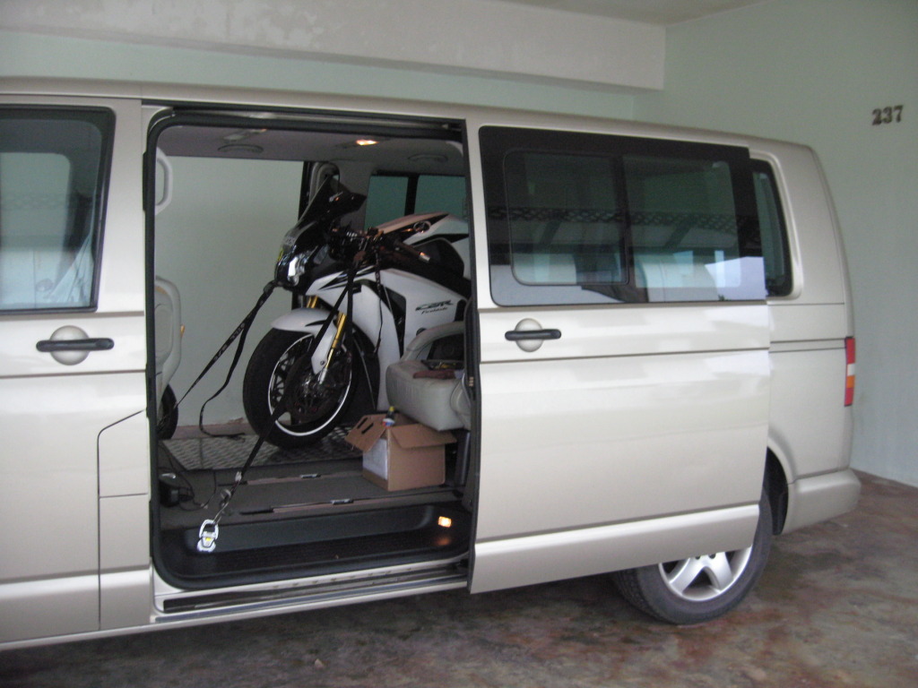

I have to agree about the van option but I am biased as I have been using a van for 4 years now.
I have a Toyota Vigo but for all the reason posted above I sought out a van and I am very happy with every aspect of using a Van compared to the pickup.

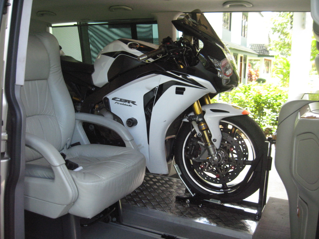

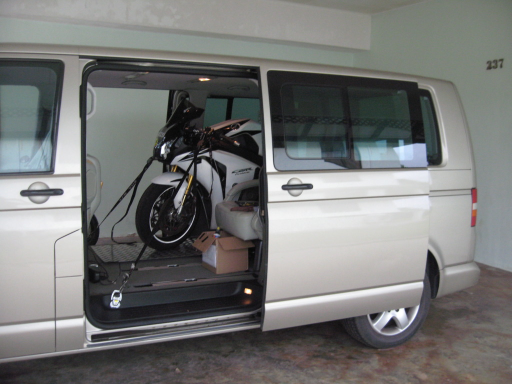

I purchased a VW Caravelle van in 2008. This Van is in the luxury end of the van market. I choose the VW because of the length. I was able to fit two CBR 1000 RR and still retain the two bucket seats in the front of the rear section. I only did this configuration in Thailand as I drive this Van to to Singapore and transport my racing Blade to Sepang a Pasir Gudang.

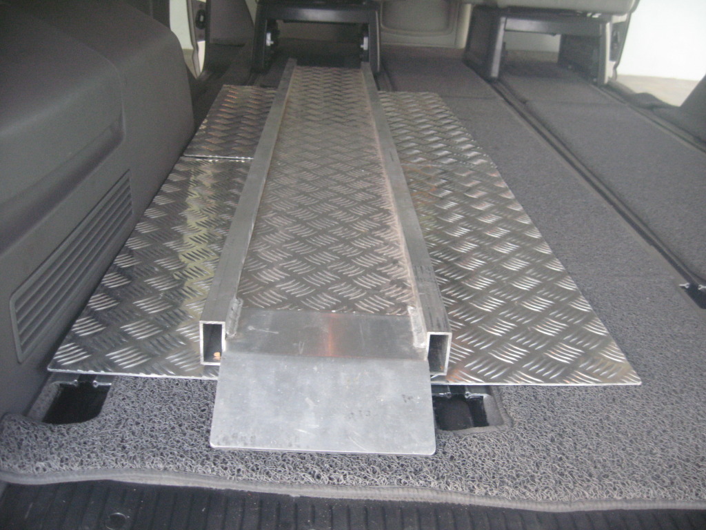

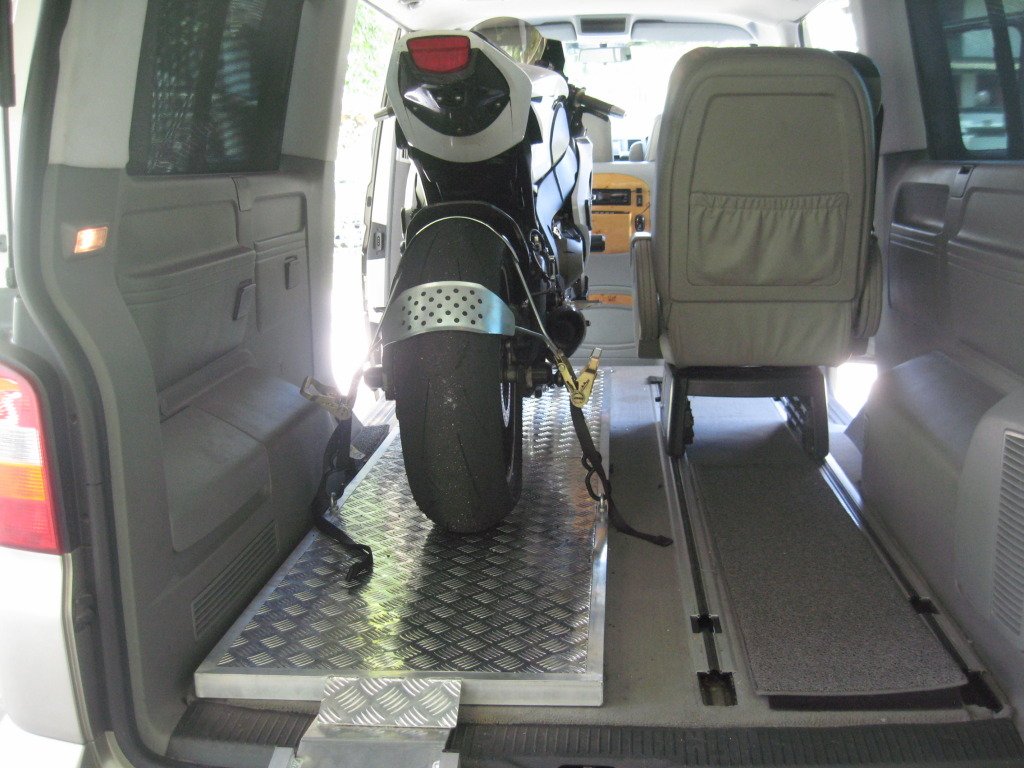

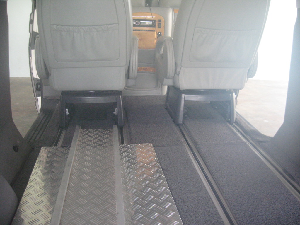

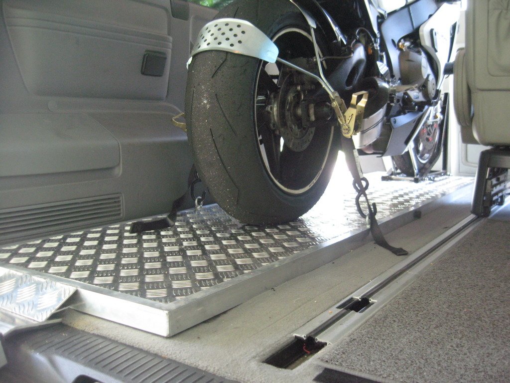

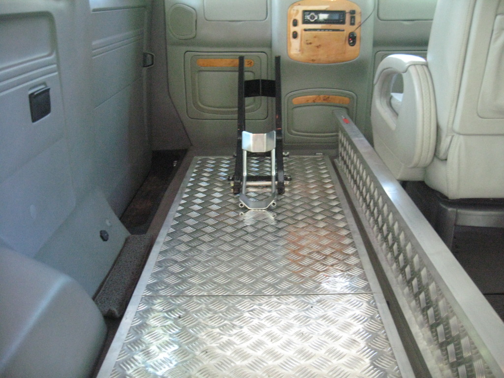

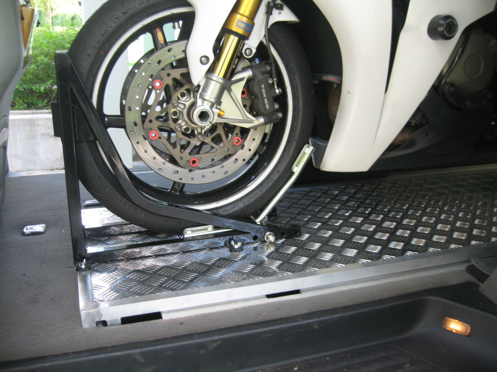

To protect my carpets and also to eliminate any tie down shackles I designed my own aluminium platforms and contacted my friend in Australia, Murray Sharp from Sharp Racing products who built them to my design and dimensions. Luckily everything fitted perfectly
The platforms are fitted with see saw front wheel retainer. This eliminates any tie downs on the front of the bike. I purchased the over tyre type tie down for the rear wheel and the eye bolts that this attaches to are part of the platforms. I split the platforms equally in two so that they can be lifted easily in and out of the van which results in the whole package being fitted by one person.
I have dirt bikes also and these bikes can just fit in in terms of height to the handle bars. There is lots of room forward and back, just the height of dirt bikes is a minor issue.

Phil, The VW is a fully imported vehicle so you get hit by the huge taxes that Thailand unfairly adds to Vehicle that have large cc motors and that are not assembled in Thailand. Same situation with our bikes!!
The top of the range Caravelle is around 3.4 million Baht. The cheapest is about 2.6 Million. Because the vehicle is considered a luxury Van, most are used to carry business people or politicians around. The current Thai PM uses one.
That means the VW is not your usual run of the mill commuter van that has been used until it is dead!!! In most cases they are serviced properly by VW so second hand examples are in good condition.
I have seen a number of used Caravelle's around ranging from 500,000 to 2 million Baht.
Mine is a 3.2 liter petrol and is thirsty (7 Kilometers per liter) if you push it over 120 KPH. From 2009 on the Vans were fitted with a 2 liter diesel with a 7 speed Auto gear box and these get up to 13 kilometers per liter so they are quiet good in terms of fuel but as you would expect from a 2 liter motor, the power is not exhilarating
I actually searched Thailand for an Iveco as these have a very high roof and are even longer than my VW however, none were to be found. I looked for a Ford transit also but same result.
My Van has proved to be an excellent all round vehicle, as it only takes me 5 minutes to remove the bike platforms and install the single bench seat in the rear and I have a large comfortable van for family trips.
The only limitations are front wheel drive and low ground clearance so you can't take it off reasonably smooth roads.

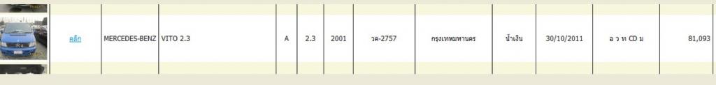

http://goo.gl/sNW2o
c34 halfway down the page.. Cant seem to link to it only..
01 Merc Vito 2.3 with a starting bid of 380..
EDIT :: Link gets mangled for some reason.. shortened it.
Yeah starting bid.. They seem to operate that way with union and tisco, not seen anything go under the hammer and not get sold, seems they 'start' from a reserve..
Usually dont run up too far either.. 10 or 20% maybe but not lots..
Theres 7% sales tax to figure in too..

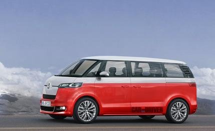

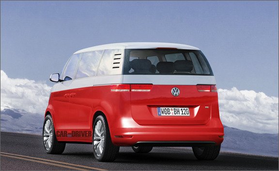

[h=1]2014 Volkswagen Microbus Rendered [/h]
2014-volkswagen-microbus-illustrations-vw-microbus-news-car-and-driver-photo-376755-s-429x262.jpg
Remember the Microbus concept Volkswagen brought to the Detroit auto show in 2001? Styled under the direction of former VW design chief Hartmut WarkuY and a pet project of erstwhile VW CEO Ferdinand Piëch, it fell out of favor when Bernd Pischetsrieder took over as CEO and installed his own design head. Although the van had moved close to production—VW even had a plant in mind to build it—its lines did not fit former Peugeot and Mercedes designer Murat Günak's styling language, and the project was cancelled in 2006.
Piëch must have made a mental note, because now the Microbus is back, on the front-wheel-drive platform of the Touran, a Golf-derived compact minivan not sold in the U.S. The retro-futuristic van likely will be just slightly smaller than the original concept, but look nearly identical. It will be unveiled in 2013, and production is expected to start in 2014.
Motivation for the new Microbus will come from several engines in VW’s parts bin, including four-cylinder gas and turbo-diesels. Power will be channeled to the front wheels through a manual transmission or VW's six- or seven-speed dual-clutch gearboxes. All-wheel drive is a possibility, and VW might build a range-extended EV version in the style of the Chevrolet Volt.
U.S. sales are almost a certainty. The New Beetle had its greatest successes here, and the old "Lovebus"—which you can still buy new in Brazil as the Kombi—is still fondly remembered. Production of the Microbus will coincide with the launch of another new, bigger van, a replacement for the Chrysler-supplied Routan to be built in Tennessee on VW's own platform. It just goes to show that, in its race for world domination, VW will be paying equal attention to mainstream and niche. For that, we are grateful. View Photo Gallery
