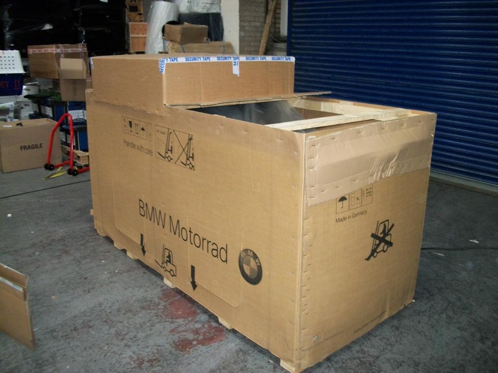

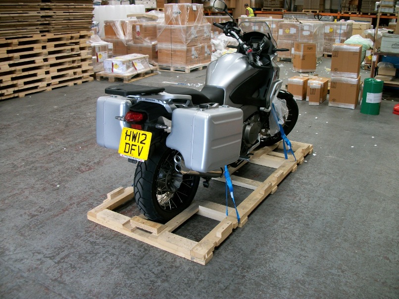

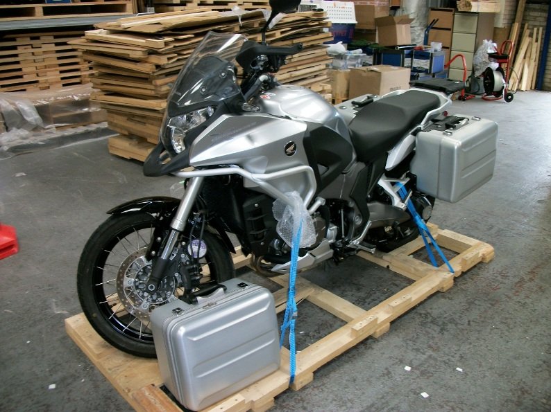

Here is my recent experiences with bringing a Motorcycle through Suvarnabhumi Airport Sept 2012.
I have been following many posts on different forums and feel the advice given here on Ride Asia Forum by Phil is definitely the most accurate available at the moment and proved invaluable to me, as for Fair andEasy Freight Company I would never use them or even recommend then, they quoted over 14000 Bht for the process below and twice as much as James Cargo for shipping from Manchester to Bangkok!!!
I thought I would be clever and do all the paperwork myself,I fell flat on my arse at the first hurdle, learnt a lot and to be very truthful a much less painful experience than Phil had.
I arrived at Customs at 09.00 and was lost in Bangkok on the bike before 13.00 , I could have easily saved 60/ 90 minutes by being organised and understanding how the process works.
As Phil mentioned there is one Lady who signs things offso you will reap what you sow if you piss her off, I tried to talk with her before the official 09.30 opening time and she just walked off into a office and closed the door!!
09.30 arrives and she reappears at her desk, and asks me for the WAY BILL so I gave her a copy and she smiled at me and said the Original,so I said 'No Have'', she say 'NO Motorcycle'!! This is when I thought WTF am I doing and walked out of here Office into the main entrance, and to my amazement I was greeted by two new best friends who wanted to help me [at a cost], so I basically decided on the most expensive one he wanted 1000 Bht and tells me I get bike out Quickly Quickly!! I offer him 500 and he say OK, I personally cannot remember how many offices and Photo copies we did so take plenty of your passport and arrival stamp!!
So here's how it went with my personal Fixer.
To enter the FREE Zone you need a pass this is only available from the main gate cost 27 Bht, from here we hitched a ride in aTruck through Free Zone Security to the Thai Cargo building on arrival there we needed another access badge and you deposit your passport to get this, go upstairs with the Photo copy of my way bill and passport, I then paid another707 Bht to get the original documents that came with the bike, I think the 707if for off loading and other FEES! Head out of the Cargo Building and catch the free bus that takes you to the exit of the free Zone.
Back into the main Customs building armed with my Original Waybill, gave that my Passport, Registration Certificate and Motorcycle Purchase Invoice to the Customs lady, who had no customers this was 10.45 we sat there in the main Office she just sat typing away then prints out somef orms heads into the big Bosses office and returns out with Simplified Customs Declaration Form for me to sign, and that was that called into another office across the hall way to get another signature and Stamp on the way bill then outof the Main building heading back to the FREE ZONE again to collect the bike the time now was 11.40, caught the free bus back to the Thai Cargo Building again deposited my Passport for a entry pass, up stairs again two more offices and more stamps on the Way Bill.
Then we are off down stairs the time was 12.00 the place was absolute madness, found the bike moved it to a clear area de boxed it, fit the top box and 1 mirror, removed the 4 straps, one of the Customs Guys came across to check all the paper work, engine and Chassis numbers matched and rodeit out of the building down the loading ramp to the exit gate with the fixer,again documents checked and stamped the time now 12.40 back to the main Customs build loaded all my gear clothed up then off all before 13.00.
So anyone looking to do the same I would recommend afixer, they know everything, everyone and all the offices you need to visit so just tag along.
If I had a FREE ZONE pass and the original Way Bill in my hand and on the Customs desk at 9.30 I feel I would have been away 11.30 at the latest, I was lucky my bike was shipped assembled only one mirror and the topbox removed, even the battery was not disconnected!!!
Sorry I am still trying to find the Telephone number ofthe fixer I used as soon as I have it I will post.
Basically you need the following items.
1. Original waybill
2. FreeZone Pass
3. Purchase Invoice for the bike
4. Registration Document for the bike in your name [ I only had a photocopy]
5. Passport with ONLY a TOURIST VISA [ thanks to Phil I made a quick visit to Laos the weekbefore change my O Visa]
Any questions let me know
