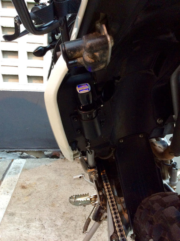

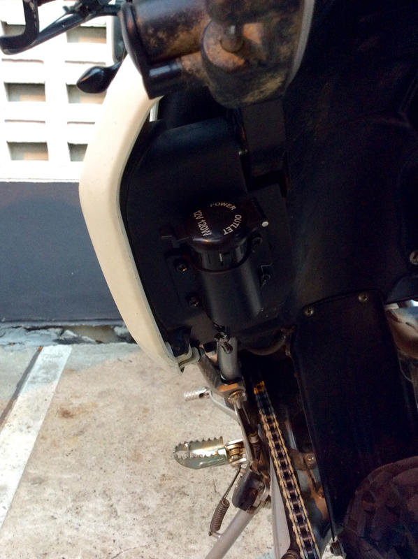

I don't use a tank bag so run a cigarette lighter, again directly from the battery, to the rear of the bike. Into that I insert a dual USB charger when charging camera batteries in my rear luggage, using a long USB cable. When not in use I close the cover.
848ed16649db0695888e8fd477ffb345_zpsxzx1u5so.jpg d91cd3a0e7b2a841fd930b3da691b522_zpsbnt4sspd.jpg
I previously connected a dual port USB charger directly to the battery but it constantly drained power (not that much) and internal parts came loose from riding over rocky ground causing it to fail. I find the 12v cigarette lighter much more reliable as there are no parts inside to work loose.

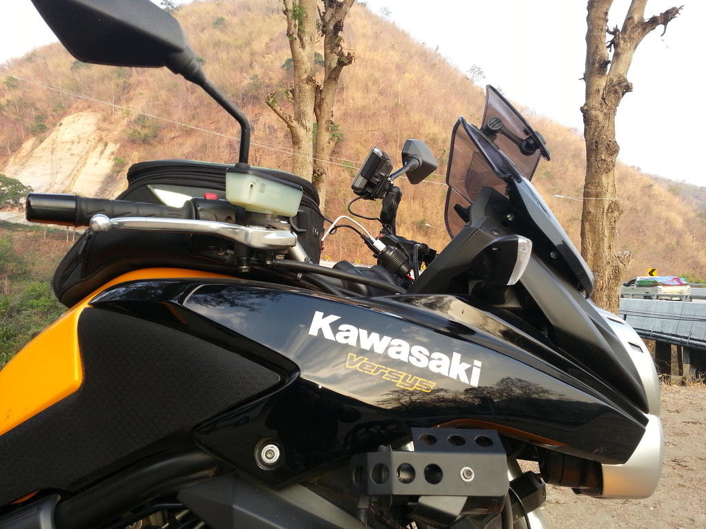

As you can see from the below picture i had mine mounted on the handle bars and would run the USB cable into my tank bag and just connect what i needed
Grant, what about heavy rain getting into the USB connections? No problem?
Sent from my ASUS_Z00AD using Tapatalk
The USB charger had a rubber cover that if it was raining I would cover. Never had any problem with water getting side and I used it on the bike for 2 years and have not long sold the bike and I left it mounted for the new owner.
