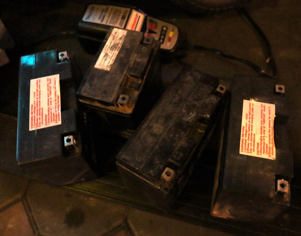

Sick of replacing Suzuki DRZ 400 batteries that seem to fail if they're allowed to run flat at 3,500 bht a pop?
![old batt.jpg old batt.jpg](https://www.rideasia.net/motorcycle-forum/data/attachments/9/9244-913a30a8735e0c3e9c99db64a3280a36.jpg)

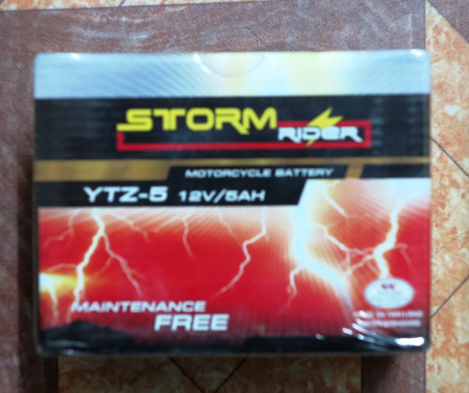

The DRZ 400 battery is an odd size, I've tried several times in the past to match it with no success. Today I had another try and found this, a battery with the same height and width in Chiang Mai for 350 bht
![batt side.jpg batt side.jpg](https://www.rideasia.net/motorcycle-forum/data/attachments/9/9245-46b660e80709a4fbe41149a810927a12.jpg)

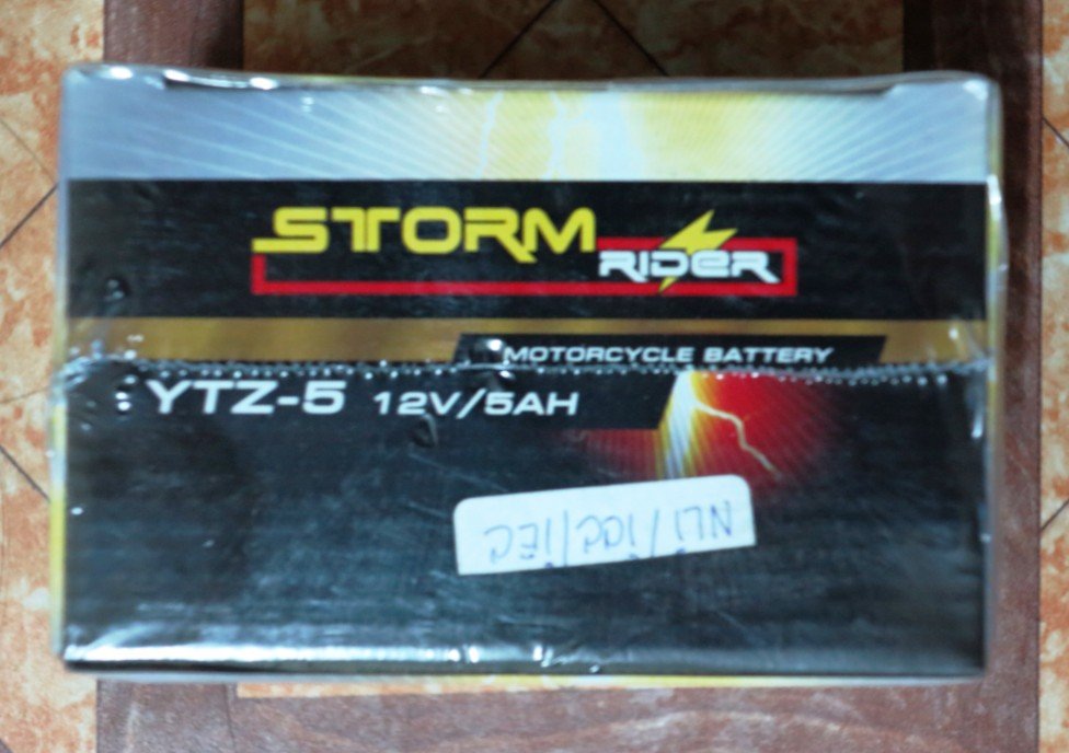

2 small problems with it
1. The battery is smaller in length and therefore has less capacity, rated 5 a/h, ive tested it and it has plenty of cold cranking amps to turn over the cold engine
2. The terminals are the other way around which meant some fiddling to get the battery terminals connected.
It's a dry cell battery & might be a great cheap alternative
![batt top.jpg batt top.jpg](https://www.rideasia.net/motorcycle-forum/data/attachments/9/9246-aaef41e7cacaee936b2aad8d9ee43bf8.jpg)
