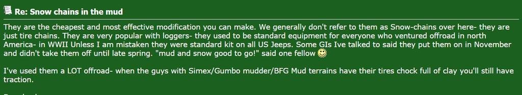

Tired and tested by Land Rovers in mud? looks like a great cheap way to get through mud?
From the Land Rover Forum:

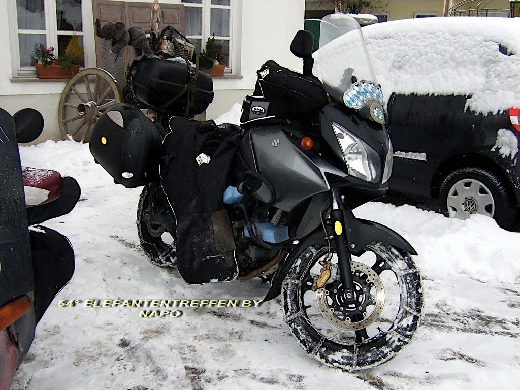

Proper motorcycle chains fitted to the bike should be going across (only) in the front (for better control) and have a diagonal criss-cross pattern in the back, ideal tie strategy is with a strong rubber ring near the inside of the rim and tied across...or so experience taught me. Works on black ice and slippery wet clay as well...just the dumbass laws and the few law enforcement in most Canadian provinces dumb enough to apply it will see you with a hefty fine if caught (luckily when conditions are that bad not many cops run around looking for people infringing into the no chains and studded tires law...)
Like this Suzuki is a perfect example how to (sorry I'm too lazy to go dig for my own pics):
1024x768xelefantentreffen_2010_by_lubrano_mario__napo_jpg_pagespeed_ic_J7DgVQO7qL.jpg

Observation suggests that most of you never really did ride in the winter (meaning northern hemisphere in sub-zero temperatures and plenty of precipitation, wind and all that comes with it...).....no insult intended of course.
Properly fitted chains: in the front they go across and yes usually sit between the knobbies but are higher and add a significant amount of stability and directional control...in the rear the cris-cross diagonal pattern doesn't really allow the chain to fall between the knobbies and traction is significantly improved versus knobby tire only.
Tested and tried plenty from Switzerland to Norway and lots of Canadian and Alaskan "roads" including slippery clay. If a set is properly prepared it will take only 10 to 15 minutes to fit...makes the time well worth while compared to an unplanned ditching...
