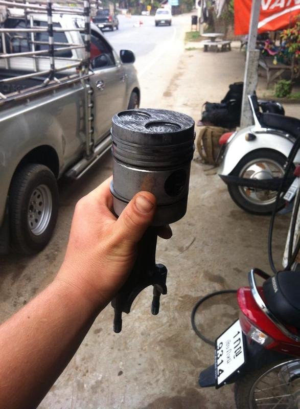

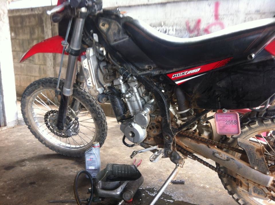

The guy who bought my KLX 250 posted these photos on Facebook last night saying it had seized
I saw him today in Mae Sariang and he said it was caused because the bike had burnt a lot of oil and he hadn't noticed.
Over the 76000 km that I owned it for I never found it to be using any oil and I changed it every 3000 km, he is only 25 and is giving it a lot more throttle than I was, is this the likely cause for it to suddenly be using oil?, the bike has now done 80000 km.
It will be a costly reminder for him to remember to check it frequently in future as he tells me it needs a new piston, valve and cylinder head

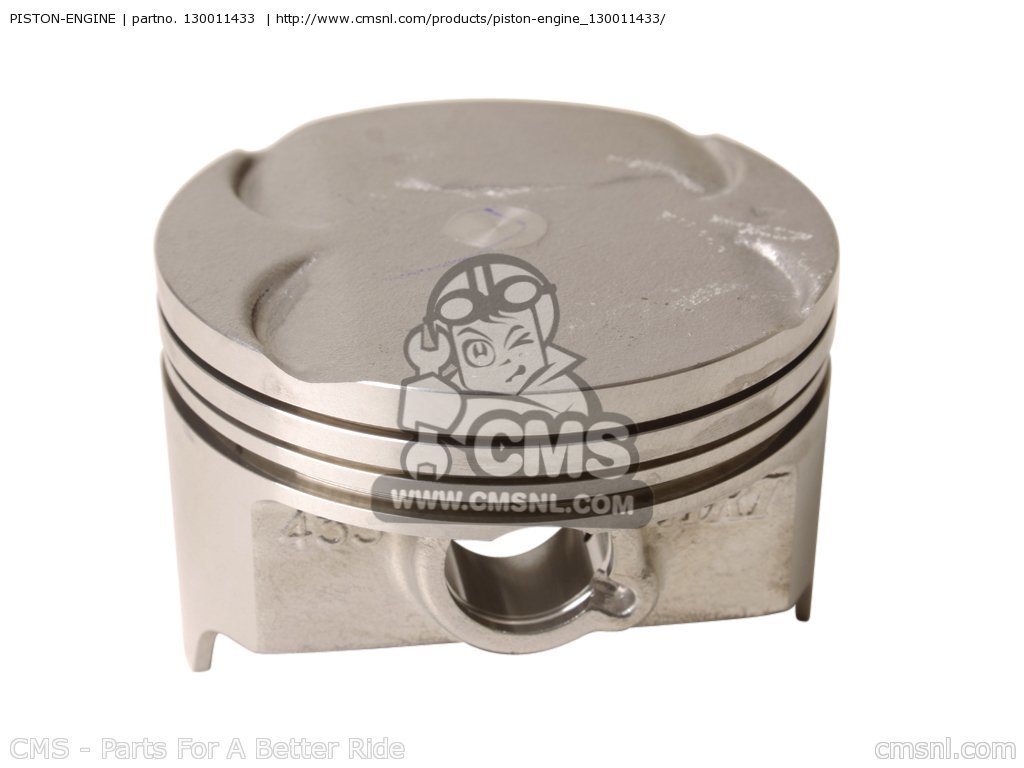

"The piston in the picture does not look like a KLX250 piston."
I would have to agree. Unless the mechanic has an incredibly small thumb, that piston looks a lot larger than the stock bore - 72mm (2.8")
It looks about right to me. If not then it's a Cylinder from a Wankel engine :?
Doesn't a KLX250 have 4 valves? The piston shown looks like a 2 valve piston IMO.
