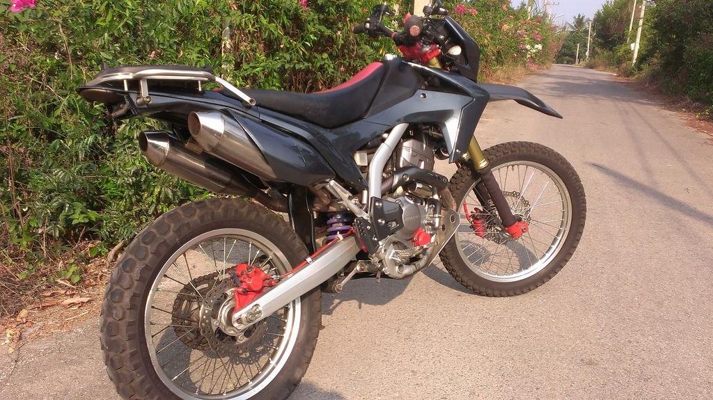

Just a slight disagreement, general consensus is lighter oil is better, not heavier. Heavier oil you may get hydraulic lock or just slower damping action. There is a ton of research out, check it out for yourself! I have a crf, coz of being here in Thai RT is great but wanted to upgrade myself and they dont use progressive springs(not sure why), which I feel and have researched are a great way to go.

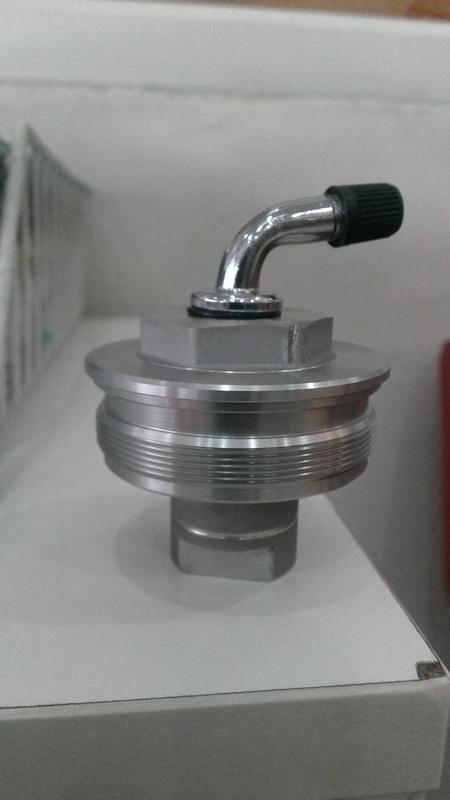

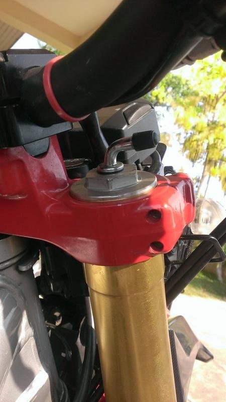

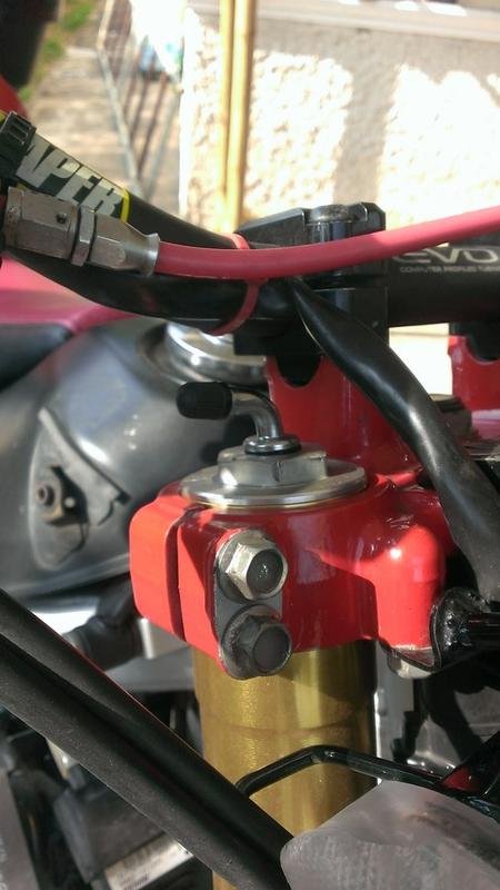

I added an EPM progressive spring for my weight and expertise, changed the oil, I added air valves like the old style forks to take a bit of sag and preload-just a personal preference. I think I am going to add the gold valves on the dampner side. But they handle ok as they are. The rear shock is stoch but again added an EPM progressive spring for my weight, and it did make it better, now, as good as a completely new show(RT, YSS, Ohlins)? Probably now but then cost a lot less. I dont race anymore, so dropping almost a Grand on a shock to me was not cost effective.
Anyway, thats what I did, again all mods are personal, depends on ur riding, bankbook, etc.
Ask a Q if interested!
