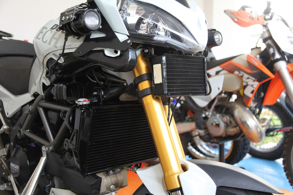

I burst one of the passes on my Multistrada's radiator on a trip around the MHS loop a while ago. Ducati sells these for $1,200 !!! I tried in vain to get it repaired, it was only a pin hole but no-one would repair it as it was aluminium.

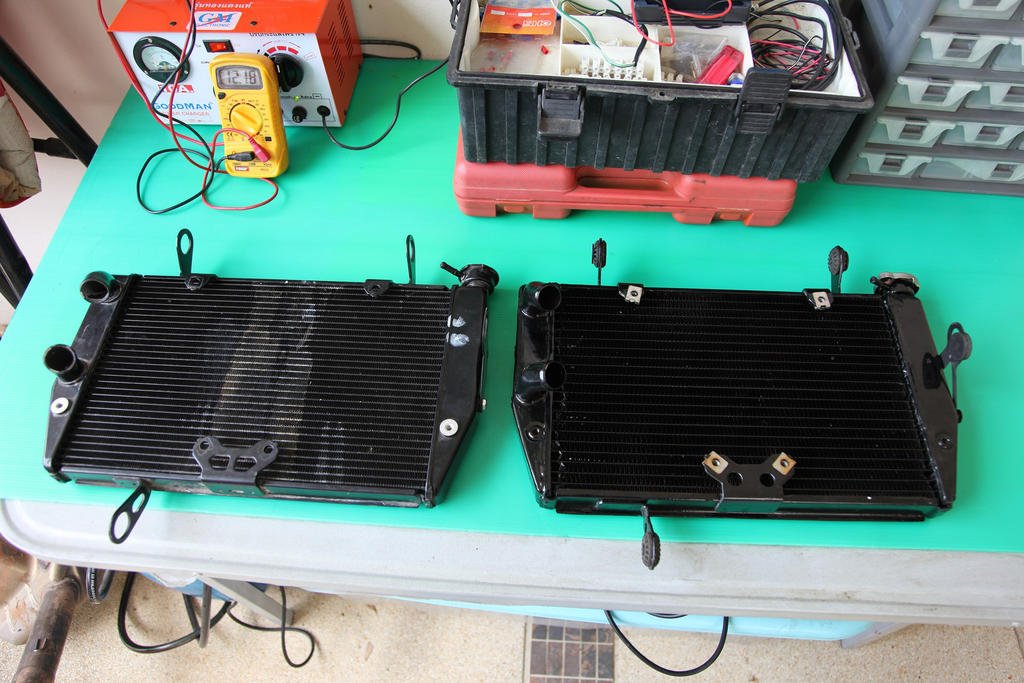

Liam managed to find a shop who could make a replica for a fraction of the cost. It turned up today and i am gobsmacked at the result. See photo below you wouldn't know the difference. The replica is fabricated from copper which makes it a wee bit more heavier. It will be easier to repair now too if it goes tits up.
Apparently it was an old lady who made it - I wish I had a granny like that...
If you need anything like this made up contact Liam to be sure!

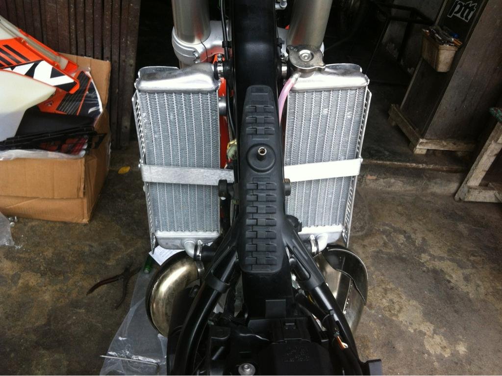

Ton fixed my totally bent ktm radiator (also alu) for free. It looks as good as new and took him about 10minutes.
This is the after picture (I then decided to put radiator guards :) )

That's an unbelievable price as well as looking the part. Theres plenty of hours work involved making that for sure. Excellent find Johnny.

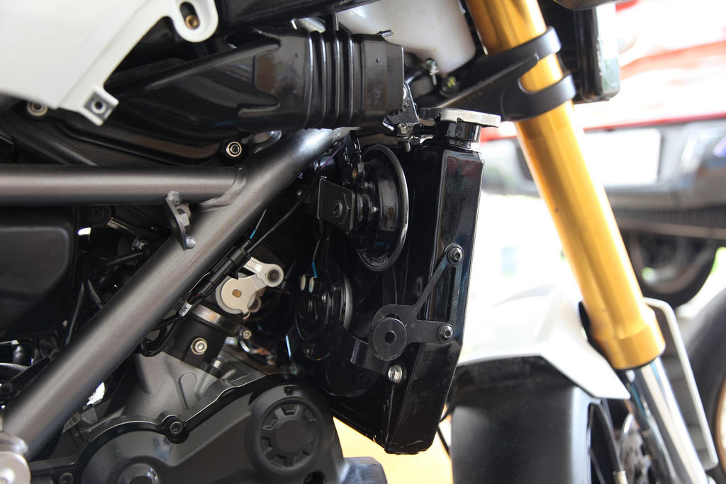

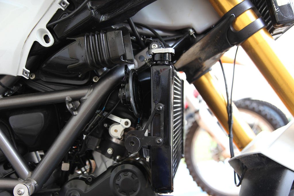

Radiator mounted perfect. Fans located perfect. Tested up to 105C - fans operated as per spec and no leaks.
"Theres plenty of hours work involved making that for sure" Apparently it took a week to fabricate!
