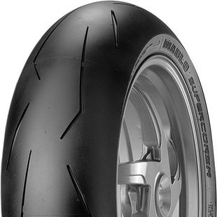

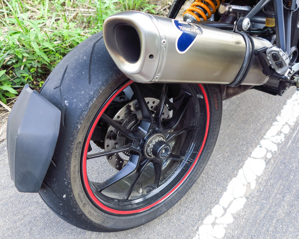

Naked
Best; pirelli wet/ good pirelli supercorsa/ average pirelli rosso corsa... here you may want to say; hey what about diablo rosso 2... Answer not enough lean angle available on those if you reach or are at a level or intent on saving cash.... if not then consider them good in your case and you will get a softer more plush ride than on a set of supercorsa's lets say but not in regards to the wet's'
Sport Tourer 17 inch wheels
Best; pirelli diablo rosso corsa... here you might say; he's gone limp on us what about supercorsa's.... Answer well if you're riding a Sport Tourer you want be fast for lets say at least 600 km a day right? The supercorsa's will pain you over more than a couple of hundred km's as you feel every little bump and groove, especially on a cement road like on the way to Lampang.

Sportbikes
Best; diablo rosso corsa or supercorsa bsb... choosing diablo adds a little more comfort and no loss really but i'm not sure as i just bought the bsb'

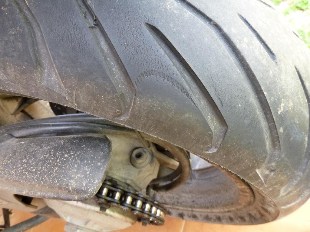

I ended up going with the new Pirelli Angel GT's to replace the old Pirelli Angel ST's on my sport tourer VFR 800.
What a transformation.
Along with tweaking the front fork pre loads the bike actually holds a line through the corners while dialling the throttle on now.
It was under steering badly with the ST's,so looking back the front was total rubbish but really happy with the new GT's.
Rear seems very grippy too and it hasn't let go once under hard cornering as the old one did many times.
I now find choosing the best soft/ grippy tire that can be used for touring very confusing. Pirelli Diablo Rosso II's, on the Ducati Hypermotard 821's, we're getting 7,000/ 8,000 km out of a rear tire (12,000 ish km out of a front). Super grippy, Pirelli Super Corsa on the rear would barely last on the rear tire for a 2,500 trip, so not ideal. How do you think the grip would compare on the Pirelli Angel GT's versus the Rosso II's? & would they wear about the same?
I don't think the ST front on mine ever worked well and wore prematurely.
The rear was ok and lasted 17k k's.
If i get that out of the new GT's i'll be very happy and to tell you the truth with the improvement in handling i wouldn't risk any of the softer grippier tires because the bike is so much better to ride i wouldn't want to give up the superior wear qualities of the Angel's.
I wouldn't try and tell anyone they hang on as well as the softer ones as they probably don't but they do eliminate the chance of exposed canvas while on a ride like many others have experienced and it is a big improvement on the previous especially the front.
Old tire after 17k k's...plenty of trips to Nan and roads with rough rocky surface...probably would have got another 2-3k k's out of it but the front was totally knackered so replaced the 2.
