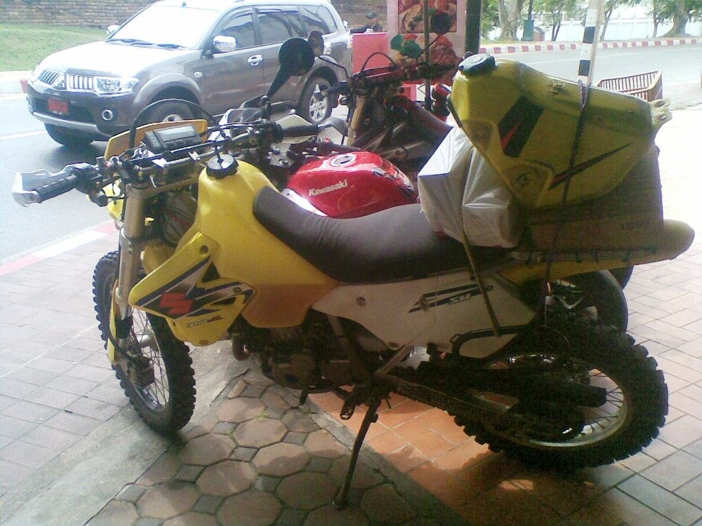

The choices of dirt bikes available in Thailand that are realistically capable of extended trail/ adventure riding through Laos & Cambodia, that are reliable is quite limited. I decided to convert a Suzuki DRZ 400 SM (Super Moto) for this purpose.
The main reasons for this choice were:
1. proven reliable engine that holds nearly 2 litres of oil
2. reasonably easy to source, lots in Thailand that have been imported from japan
3. legal Thai registration, so they can be taken across borders
4. good value for money - a used model in decent condition with legal registration can be had for around 150,000-160,000 Thai baht
5. good power - loaded down with gear for a 2 week trail riding trip does not struggle where a 250cc bike may.

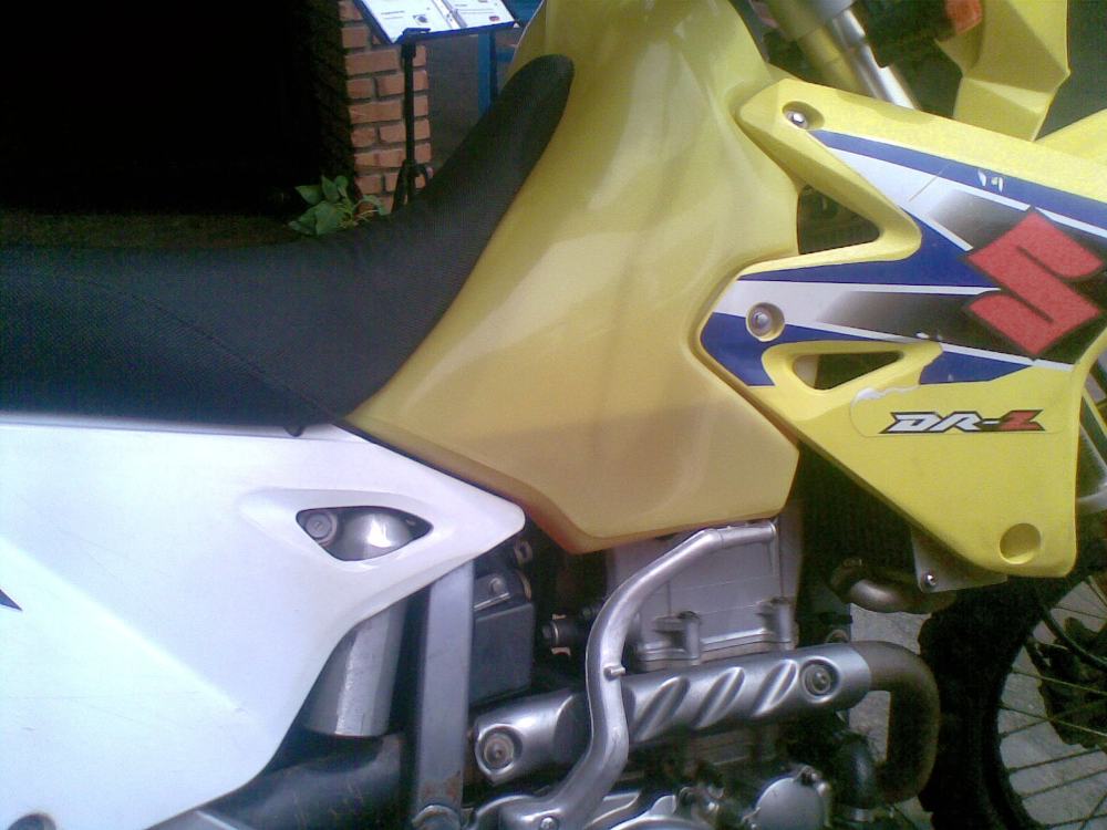

I like as much fuel range as is sensibly possible. When poking around in the middle of no-where, once you're down to less half tank on a standard fuel tank,i dont care what anyone says everyone starts thinking about fuel.
I've put a Clarke 3.9 gallon (14.7 litre) plastic fuel tank on this bike. The standard fuel tank is 2.64 gallons, so this is a 44% increase in capacity. Trail riding you can use an estimate of around 170-180 km of riding range from a standard DRZ 400 fuel tank, the larger tank should then bring the range up to around 265km under inefficient riding conditions. (NOTE THE KICK START LEVER JUST UNDER THE FUEL TANK)
Clarke 3.9gal is a good value for money tank. I had to grind a bit off my kickstart for it to fit under the tank. It still slightly touches so I just run a piece of yellow duc tape under the tank.
I have an IMS 3.2 on my other DRZ which is thicker plastic and looks a bit better, but less capacity than the Clarke.
Agree, its better to have the shrouds absorb any falls rather than the tank itself like the Safari and 4gal IMS.
I also prefer not to have too much fuel/weight fwd as the DRZ already feels a bit front heavy.

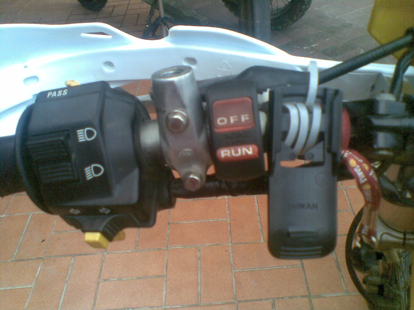

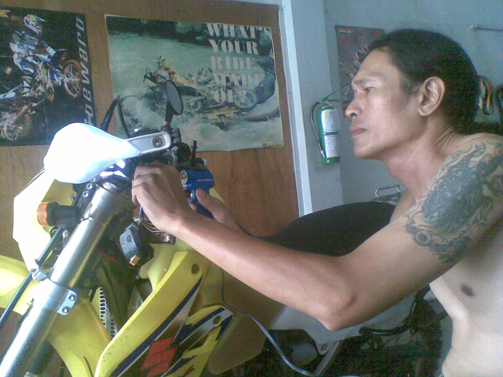

Latest modification today was to splice an on/off switch into the headlight wiring loom. If your stalling or dropping the bike on some tough terrain, being able to turn the light off to save cranking amps might make the difference between you being able to start the bike and not. It is also actually illegal to run with a headlight during the day in Cambodia, only Cambodian military and royalty can do so.
Lan managed to find a used Honda switch that would mount around the handlebar & was perfect for the job, below splicing the switch wiring into the headlight wiring loom.
Switch all fitted to the right of the light switch.
