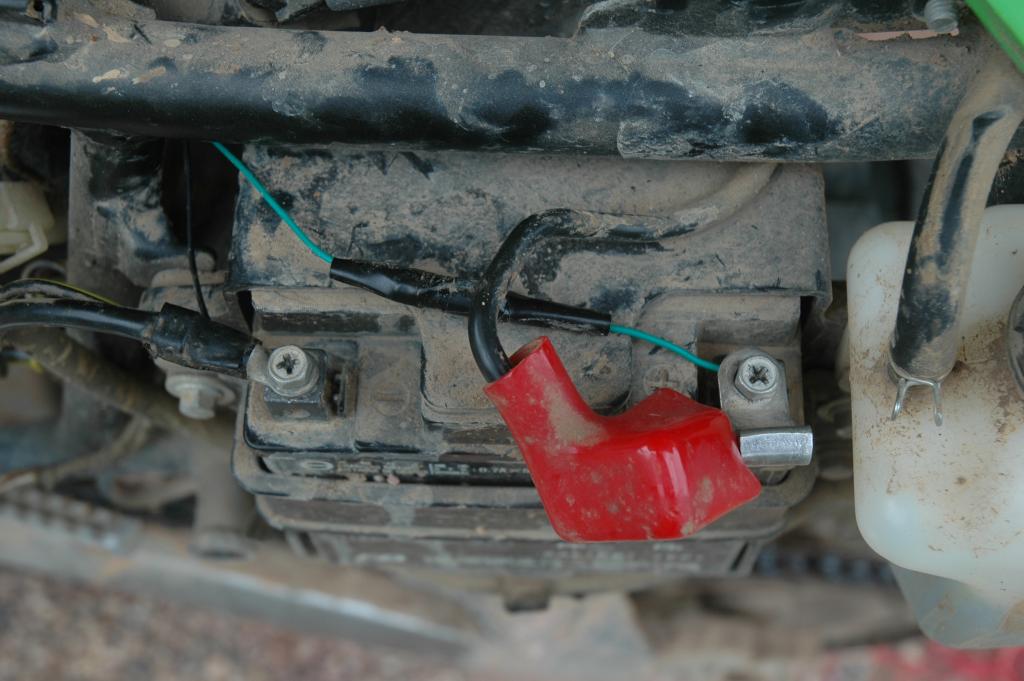

Mounting to the bike, in this case a 2011 KLX-250.
All bikes are gonna be slightly different, but this'll give you the general idea.
Wires screwed to the battery, make sure the wires with the home made terminals or proper terminals sit under the main bike terminals.
This helps to prevent damage to the wires and possible breakage.

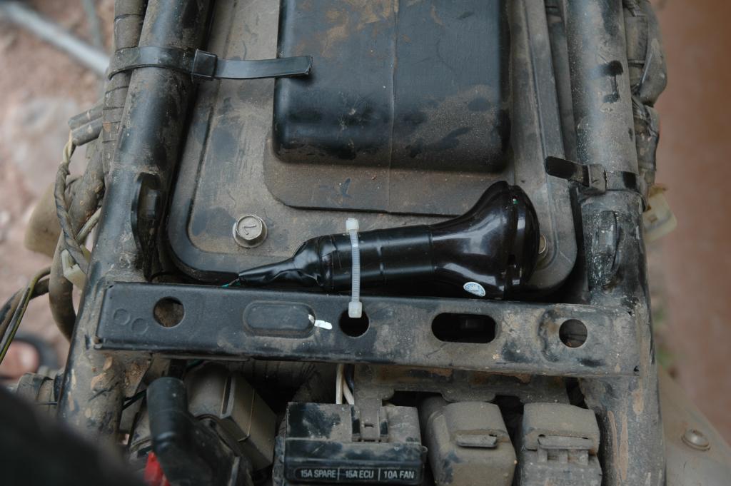

Adapter ty-wrapped in a convenient place under the KLX's seat.

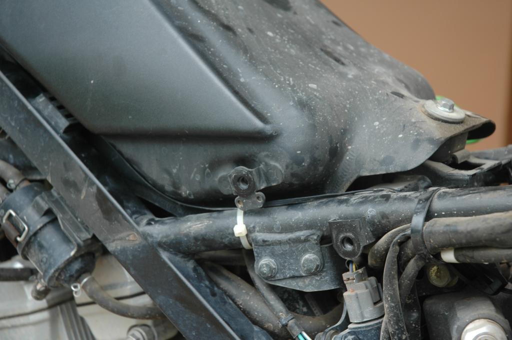

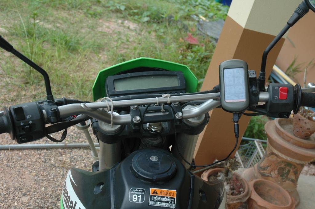

Wire run up the side of the fuel tank towards the forks, ty-wrapped in place.
A few more strategically placed ty-wraps, and job's a good'un.
