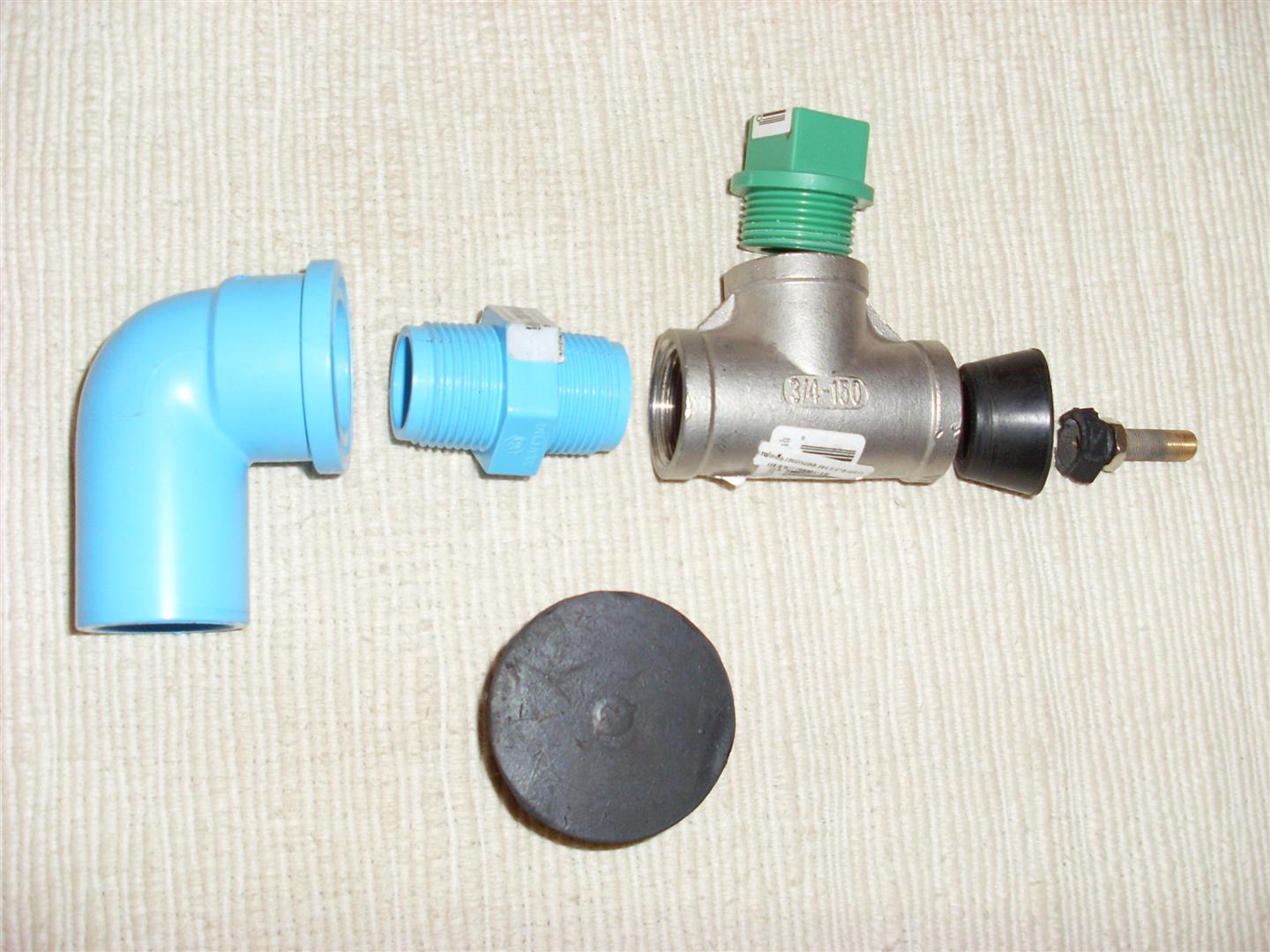

Well the correct size inlet manifold gave me more options for the PVC elbow and a T piece with a blank threaded end that i should be able to drill and fit the low pressure gauge to when it arrives.
Here`s what i found at Global House for 130 baht. edit;i found the blank plugs at a car parts shop on Kaeo Nawarat road just east of the bridge @ 70 baht.
It`ll be put together with thread tape and silicone as it`s all threaded except for the exhaust plug,it will have to forced in and hopefully hold with 6-7 psi?
Just need someone with a vice and drill i can use to fit the Schrader valve to at the end of it.
With the gauge at about 500 baht total of 700 baht all up.

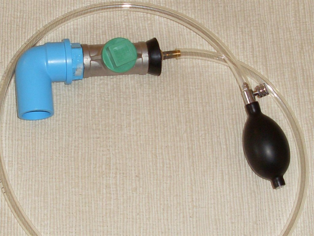

I managed to find a small medical type hand pump with a valve in CM for 100 baht.
It`s a better/safer way of metering a small amount of air into the cases as only 6 psi is needed.
Just waiting on my 0-15 psi gauge which will be tapped into the green plastic blank plug and it`s ready to use. I could probably have found a gauge somewhere in CM but i spent a couple of days hunting around in the heat for what i`ve got so i`ve had enough of it really 555
Any 2 stroke that has had a complete tear down should be tested this way before it`s slotted back into the bike...which didn`t happen with mine as Thai mechanics don`t seem to have any idea of this type of test....you live and learn :hmm

Just out of interest the best advice i could get is that 2 stroke crankcases should be pumped to 6psi and hold at least 4psi after 10 mins.
I pumped mine to 6psi and it was at 5 1/2psi after more than 10 mins.
So it`s passed the test and wont be having the cases split.
