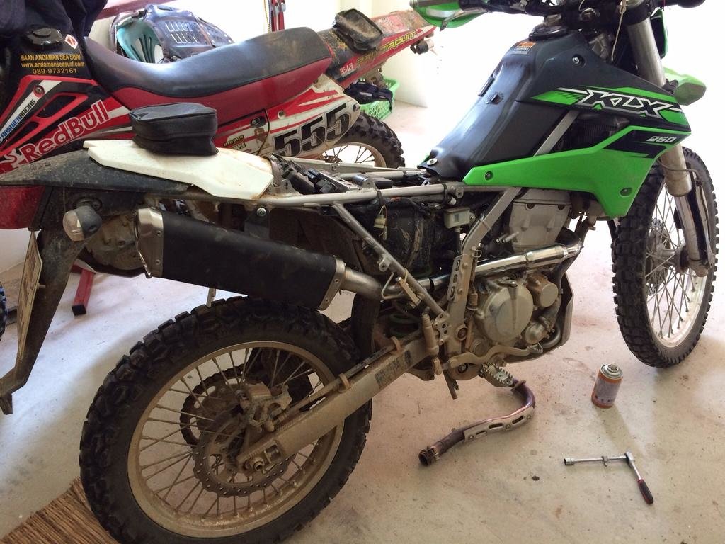

i have a Klx 250 2014 with a full new exhaust system with modified air snorkel and new filter, am running 14 on the front at the moment but may change to 13.
I have installed a new EJK Gen 3 but with little improvement.
Does any 1 have settings they are using and is working well ?
any other ideas to improve this bike would be helpful. I'm happy with the bike so far but I'm sure there maybe more improve I can do.
thanks

Changing the front sprocket will help with off road riding for sure, i fitting an EJK unit to my old KLX and found almost no difference. Have you done the wire loop bypass to bypass the rev limiter, thats one of the easiest mod's plus this mod i had done locally.
http://www.rideasia.net/motorcycle-forum/bike-talk/3920-klx-250-camshaft-mod-chiang-rai.html
Hi
thats for the reply, I will give it a trial and if no luck I will disconnect it. I will look into the bypass idea and see how that goes.
