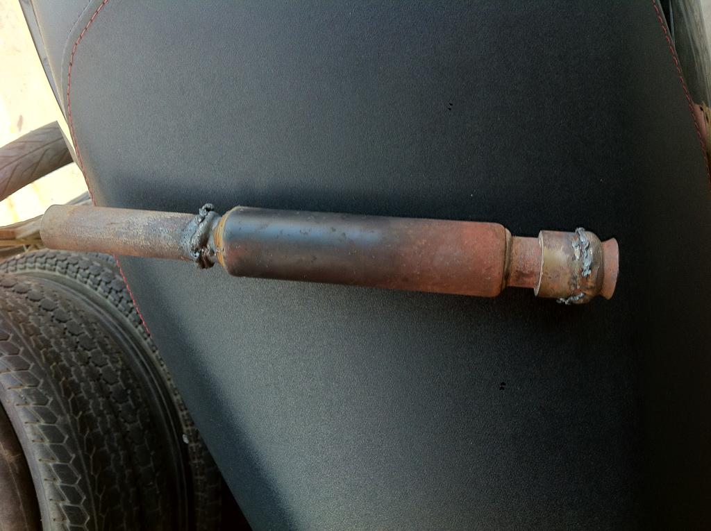

The stock downpipe seems restrictive, I got one made with a larger bore pipe, and I'm sure it makes a difference. Also I got a local made silencer which saves a load of weight
I'd like to get a local made powerbomb, but I dont know whether the design is any good. Can anyone verify their designs?
