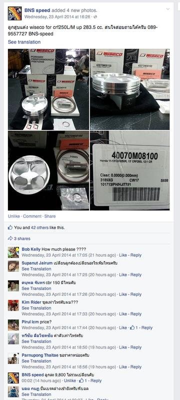

LivinLos already commented on my FB page but for 9,800 baht engine parts are cheap in LOS so it could work.

can barely read but i believe this is for a CRF? .could I have more info ,is any 305cc available and where you bought it please?
'burning shop' .got it .i'll give it a try ,thnx

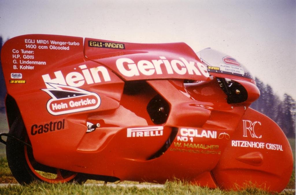

BTW...here is that famous Egli that Urs Wenger built and ran 3 world records in one singe day...with my coatings (Plasma Technik sticker on the windshield) that made the engine work. Sorry it took me so long to dig out the pic...AND...the Colani fairing that was truly ahead of it's time (he must have thought that gasoline was already obsolete)
