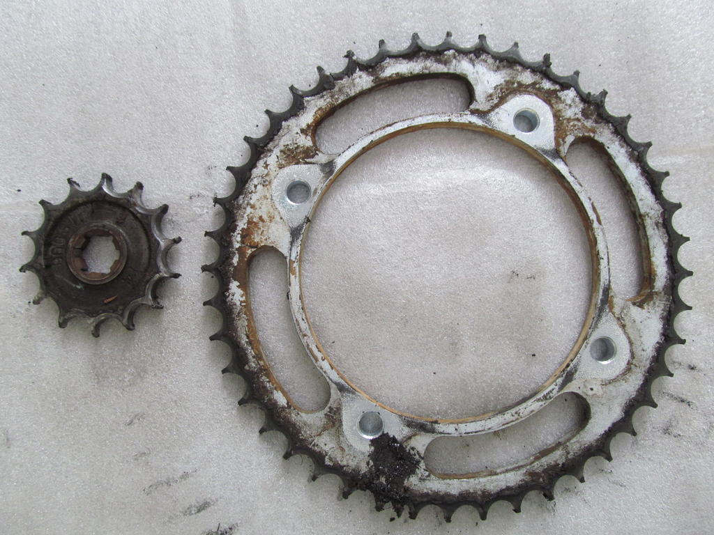

Since new the chain has needed adjusting about every 700 km and now its completely shagged after only 8600 km
A new OE one only costs about 350 Baht

Both sprockets were knackered too so a complete replacement today.
Originally the gearing was 15/43 then I changed to 14/44, today I plumped for 14/47 so now running the gearing of the KLX 125, this should be better offroad
Surprising they wore out so quick Col although a stretched chain will chew the sprockets up fairly quick.
It and the brake pads both gone already.
That's a pretty suprising photo after only 8,000km. Even with the mighty 150cc power unit I wouldnt expect to see anything near as bad as that. It really just shows the quality of the parts isn't what it might be.
