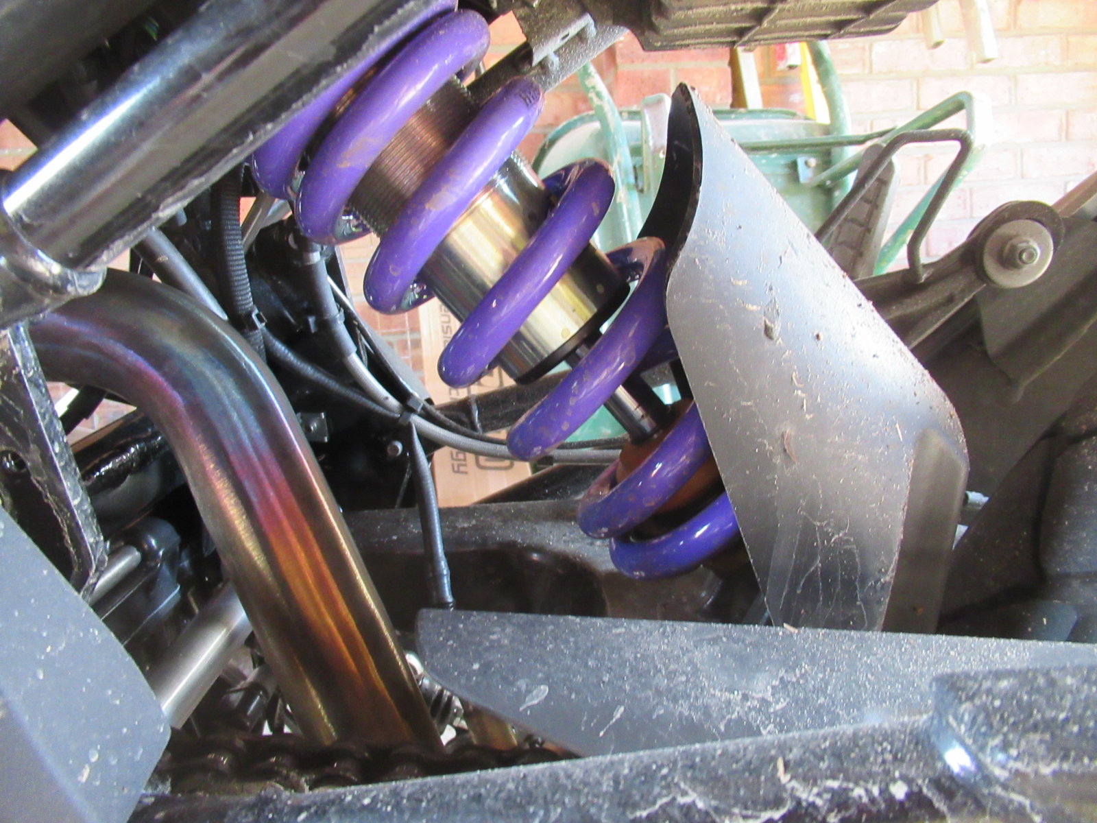

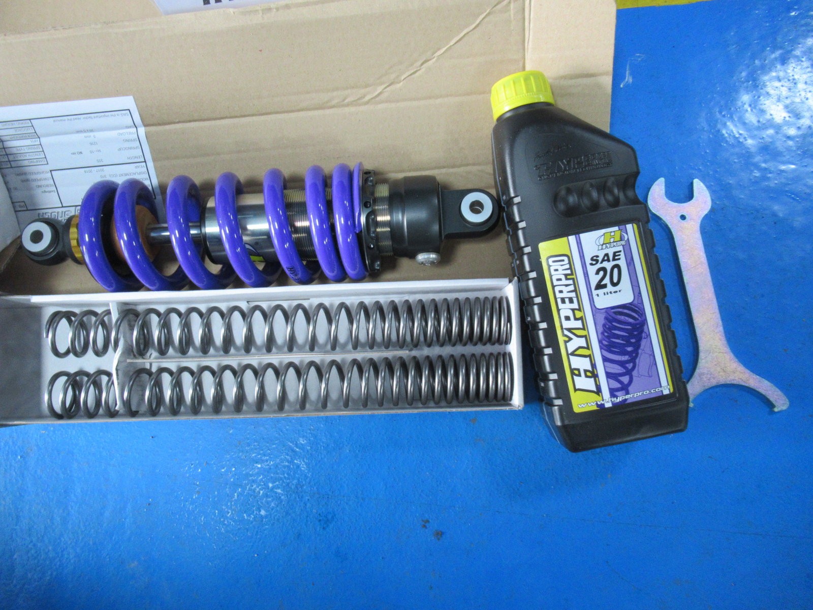

Had the Hyperpro fork springs and rear shock installed on the GS 310 and its a totally different bike now, much smoother, firmer and better going through the bends.
Had the BMW dealer install it for me, they gave me a good price to do it all. £270, 10800 Baht.
A special tool is needed which is £86 from Hyperpro but BMW make one so the dealer ordered one for their workshop which was a saving for me.
I am really happy with the results and glad I forked out the cash on it, now to just enjoy riding it
