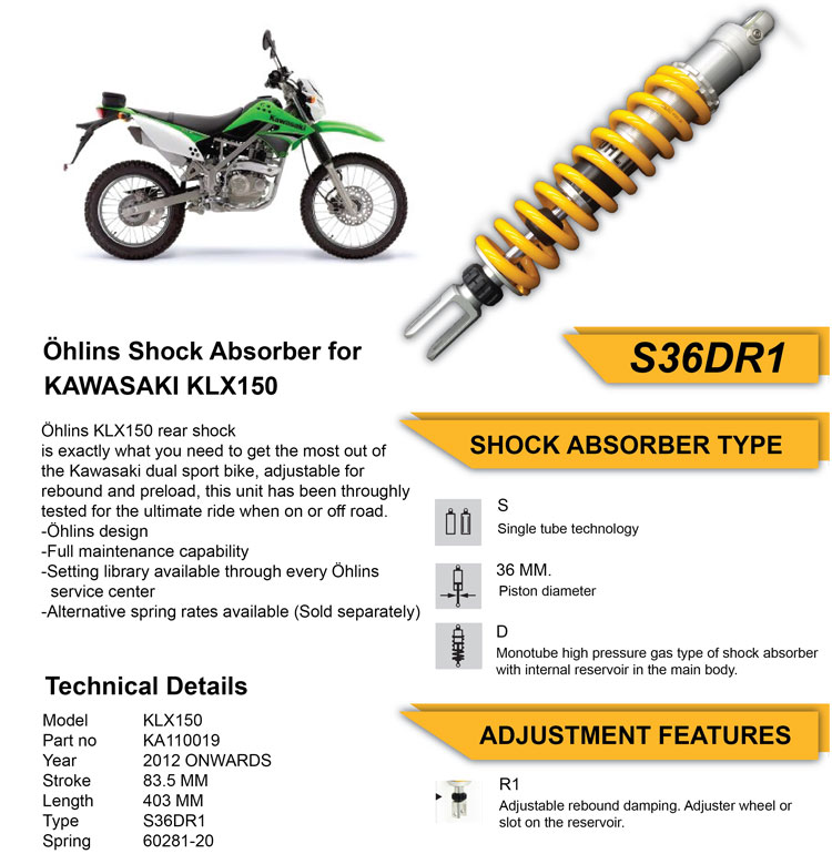

So trying to explore the legal options to make a fun off road bike, this was an experiment. It looks like it works especially for shorter people giving a lot more confidence to commit to single track switchbacks, giving it power out of tricky turns. It does need bar riders. I felt like i was doing hand stands on the bars standing up being a smaller frame than the 250's. The power increase especially torque, no stalling in the wrong gear and would pull out was amazing. With the 150 BF version having 18" & 21" wheels the ride is pretty good. BNS Burning shop say they have rear Ohlin shock for 9,000 Bht, must be a copy at that price, I will go investigate now it looks like this setup works. There is substantial vibration over 80km/ hr on the bars on the road, it feels like engine related and not wheels/ tires, one big negative.
Overall, for a legal bike in Thailand for nasty trails, this looks like an interesting option.
When I looked at the Ohlins website a rear shock for my 150 was only about 10,500 Baht Phil.
