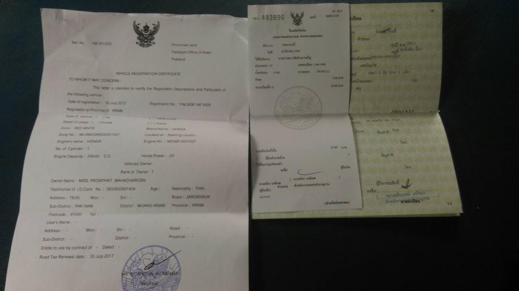

anyone have any info what documents and what details are on them to take bike registered to someone else from thailand to malaysia..
i have translation document and what looks like a receipt for translation document, it looks like i have same documents as shown in video below.
https://youtu.be/9c9Zbl1Cb4E
documents i have below
I recently asked this question and went through the procedure myself.
Indeed, you have the right documents to begin with. Now you also need a "power of attorney" form, "หนังสือมอบอำนาจ" in Thai, which you can receive for free at any Land Transport Department office. However, you will also need to purchase some stamps (some borders claim it's 10 Baht, others say 30 - I'd go for 30 just in case) which you can also obtain from the Land Transport Department. You could also use a form printed off the internet, such as this one (it's probably better to go for the "official" DLT one with the garuda emblem at the top though in theory, this one would work too): http://register.rd.go.th/rdinter/information/tor5_081150.pdf
The owner of the bike needs to fill out the form and attach a photocopy of his/her ID card (or passport, though ID card is preferred).
Then, as in the video you need to get Malaysian insurance and the ICP "international circulation permit" from the Malaysian JPJ Land Transport Department, which are located at every border crossing. You'll also need a white on black sticker, which is a translation of your bike's plate. All of these documents can be done at the border crossing by showing the translation of your registration. To save time, or if you think you might be crossing outside of office hours, there are agents located at some of the border crossings (especially Sadao) and in Hat Yai, which can do the documents for you and send them to you before you arrive at the border. I did this myself, I think it was worth it, though technically you might save a few Baht by doing it yourself.
ah perfect many thanks just the info i was looking for ....dont understand the stamps bit though never heard of them
