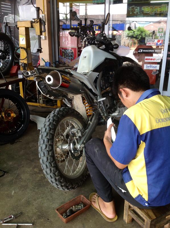

Nick, I'm taking my CRF up on the train in a few weeks (14/06) and will have the full FMF exhaust, an EJK and tail tidy fitted at TNT. I'll do a little riding in the area and then return the following weekend.
BTW they have both the Q4 and the Powercore 4, I've bought the former, which is slightly more expensive. I've bought mail order from them before and the guy seems helpful although I don't know how good his English is.

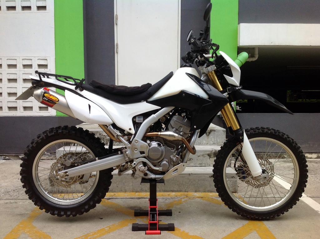

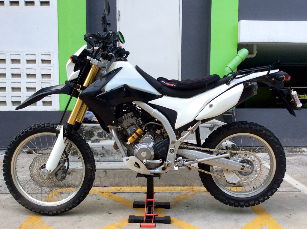

Yes Nick. It's a great little bike and makes financial sense here in Thailand. I've found it very reliable and fun and easy to ride.
It doesn't do any one thing particularly well but is versatile enough to allow me to ride through Bangkok traffic and multi-lane highways before entering jungle single tracks.
That looks very nice. Have the black bits been resprayed, Craig? The CRF looks so much better than the Kawasaki KLX.

Another question: the rack. It's a standard accessory in Thailand, isn't it? Is it sturdy enough to take a fullish 30L dry bag? That and a Wolfman Enduro Tank Bag, and I would imagine that's all you need to tour Thailand.
The rack is available locally in Chiang Rai, so is the sump guard. The wolfman enduro bag fits perfectly, as for seat covers i use the mesh cool seats, look a bit funky but keeps your bum cool.
No resprays, just pay 100฿ to have the bike cleaned occasionally.

Racks can be picked up in many different shops and off the net. TNT have two different types I believe. Sturdy for 30L. The most I've had on the back of mine is 70L of Kriega luggage. For regular weekend trips I use just a 30L Kriega, which as you say is enough for short trips here.

Yes Nick.
The guy at TNT was a pleasure to deal with and I've noticed a big difference in power and performance over stock. Coupled with a Hurricane air filter, extra fuel from the EJK and a larger rear sprocket the bike is more fun to ride and inspires greater confidence to tackle rugged off-road terrain. The downside is greater fuel consumption and a buzzy 6th gear on the road.
