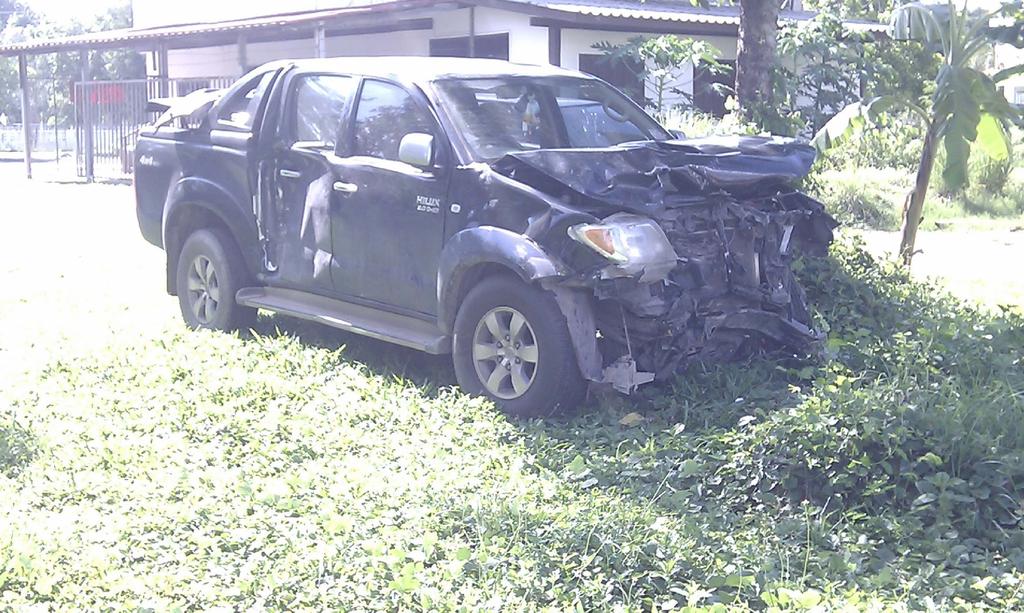

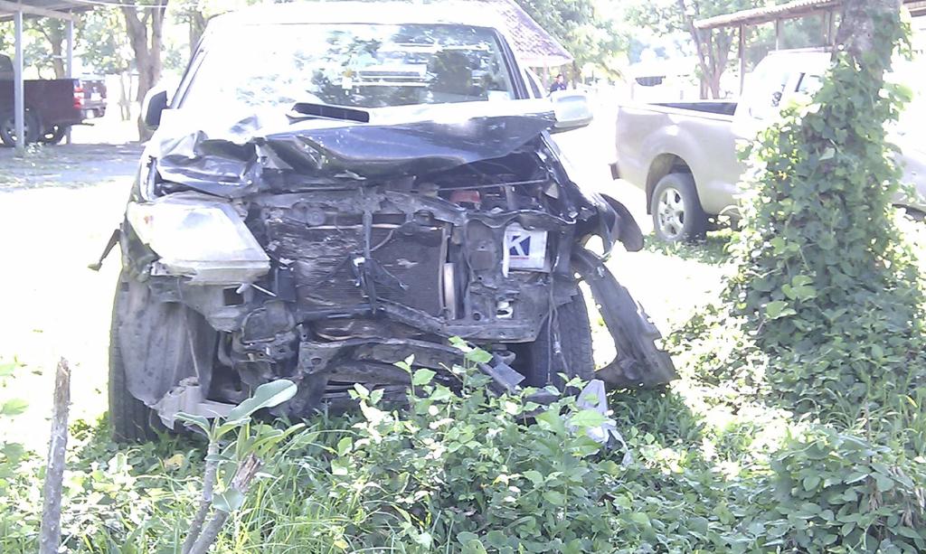

Last year on June 28, while I was driving my puppy dog Nero to a vet visit in Surin, driving way below the speed limit (max 50Km/h) alongside road works in lefthand lane, a professional driver with a truck(over)load full of gravel started passing everyone - of course invading the passing lane of the other side - causing a lady, travelling way to fast for her driving skills, to loose control and after swerving like a chicken crossing the road ended up hitting me head on. This was the result:
I ended up with some torn ligaments in the right foot (landing me in a cast for a few weeks), some air-bag burns on my left arm and a nasty bruise and swelling on my right arm...some nice black spots that showed where seatbelt did it's job...but nothing to worry really.

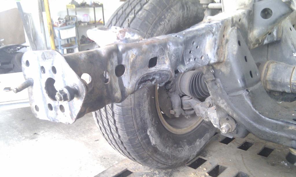

U Soun See took 9 months to work like this:
Overheating the steel and burning holes into the frame in an attempt to str8n it...which was unsuccessful of course but that didn't prevent them from just wrapping everything and handing it back to us.

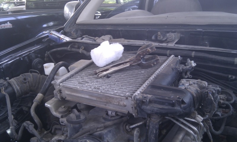

The first day I had the truck back after nine months of repairs I noticed a weird sound from the engine, intercooler busted and other things still leacking, timing belt rubbing on the broken cover that wasn't changed, broken water pump not replaced, air stopped working and the front bumper fell off.

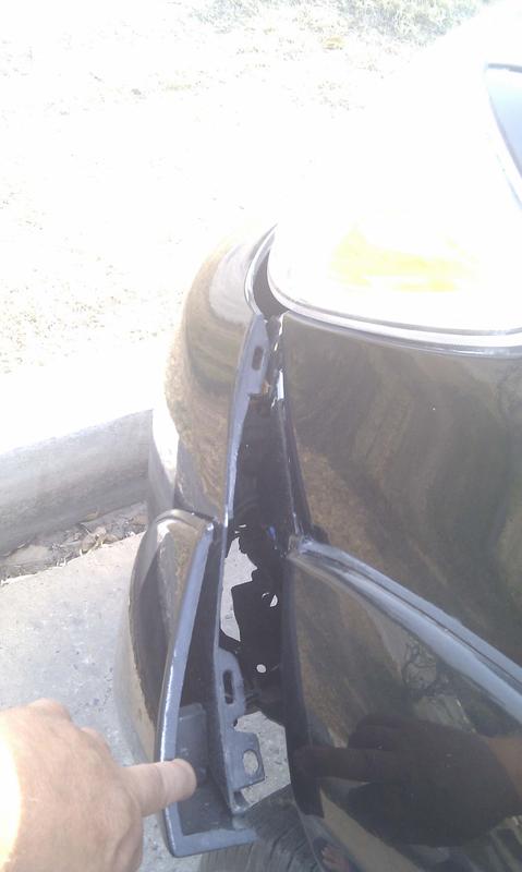

To my surprise the bumper had no screws in place, no clips either because they had to cut portions off to fit it so they just glued it on with black latex caulking...a real shitty piss poor job that screams "farangs are idiots they don't know better"...
why was the intercooler busted??? who knows???

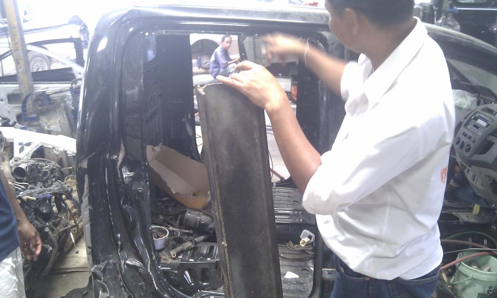

So I took a closer look and discovered a series of other things, like an airfilter that was falling around no snorkel on the fender, a bent fender, superthin paint without primer underneath, plaster falling off the frame, welded old hydraulic pipes making up the steering lines etc etc etc

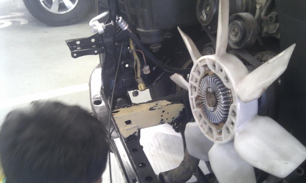

So the truck went to Toyota and it took the insurance another 2 months to work out a repair deal that they could live with and approved this:
After I got in touch with a friend at Toyota investor relations they changed their minds at Toyota and called the insurance back explaining that they could not in good conscience proceed with such a shady repair and now changing the entire front frame section, along with all the other old crap and messy jobber shit those IDIOTS at U Soun See installed.
